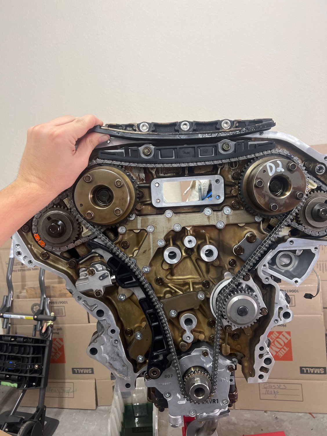

Just some thoughts for anyone planning to use Cloyes. The top guide I got from them only has 2 bolts instead of 3. Hopefully won’t be an issue.
How has it held up? I’m in between either cloyes or oem. Friend of mine told me they’re a good company and he uses them at his shop
I have a few thousand hard miles on them so far with no issues.
I see this is from just over a year ago. Timing chain still holding up fine?
Still holding strong! Rev limiter set to 7,500 and still good
