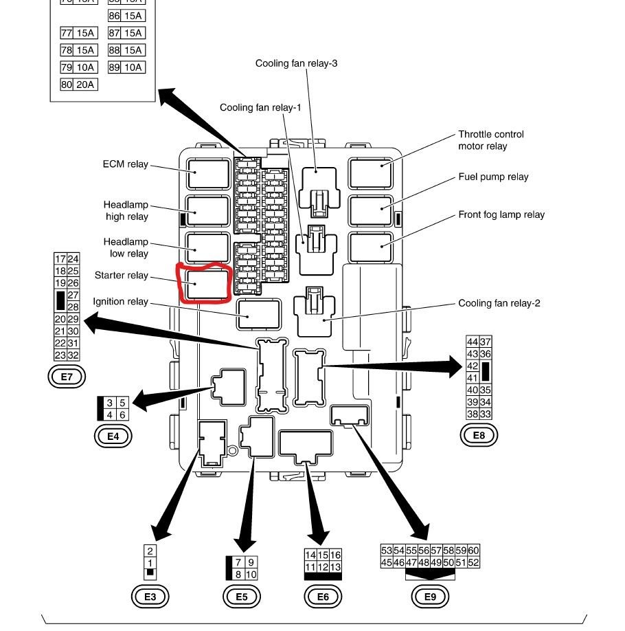

Any ideas? The engine does not crank. The battery+alternator+belts were replaced last year. I don't believe these are the cause.
I did try a sparky-mc-sparkster test > I pulled the R6 starter relay and put a jumper between the power leads, nothing, tried it with the ignition off, tried it with the ignition on, tried by turning the 'turn/start' on ignition.

My next test, which I forgot on the starter relay test is to take my multimeter and measure against the trip/relay side of the relay socket and again across the current/feed side of the relay socket. I expect to measure 12V across the current/feed sides of the relay socket and a similar 12v (?) across the trip/relay side of the socket. <<<Sanity check here, any other expectations?

Check the NATS indicator light on the left side of the dash, is it solid red when you try to crank the engine? If so plug in an OBD2 scanner and see if there's any codes. If the BCM forgot the key RFID code then it may have triggered the immobilizer, after like 5 failed start attempts the engine won't even crank once the immobilizer is fully turned on. Once it's immobilizer is locked it will be code P1610 and the start relay will no longer close.
Test for battery voltage WHILE CRANKING. If it doesn't fluctuate then there is no draw, might just be as simple as the start relay went bad. Do the HEADLIGHTS turn on high and low? This will verify the headlight relays both work and you can swap one of them with the starter relay and the other with the ignition relay just to verify they have known working relays. I'm guessing this is NOT the case since you said the dash lights dimmed when turning the key to START.
Also, have you checked the fusible link? You may have blown out fuse M in the fusible link which powers the starter.
There is also a clutch PNP interlock on both the 6MT and 5AT. These would prevent the starter from engaging as well.
I'd start with these steps before bench testing the starter since all this stuff is easily accessible from the top of the car.
Ask your son EXACTLY what he remembers about it not starting, did the engine crank but just not catch? If it didn't crank did it at least make a CLICK as the starter tried to engage?
Sounds like right now it won't even click and try to engage the starter gear yes?

I did swap the fuse and test it, no go. Initially my concern was that the starter was a 30A and the headlight was a 20A (or something like that). Either way, I figured a quick test to hear the starter start would be OK, no go though. No click of the starter engaging.
Since then the battery has died. I did charge the battery up but now as soon as I apply the power cables the lights+horn start going off. Using the key does nothing to stop this. Of note, I only have the physical key. There is no FOB or smart key. Does the car time out if there is no smart key? I'll hook up a code reader to see if the immobilizer has kicked in.
