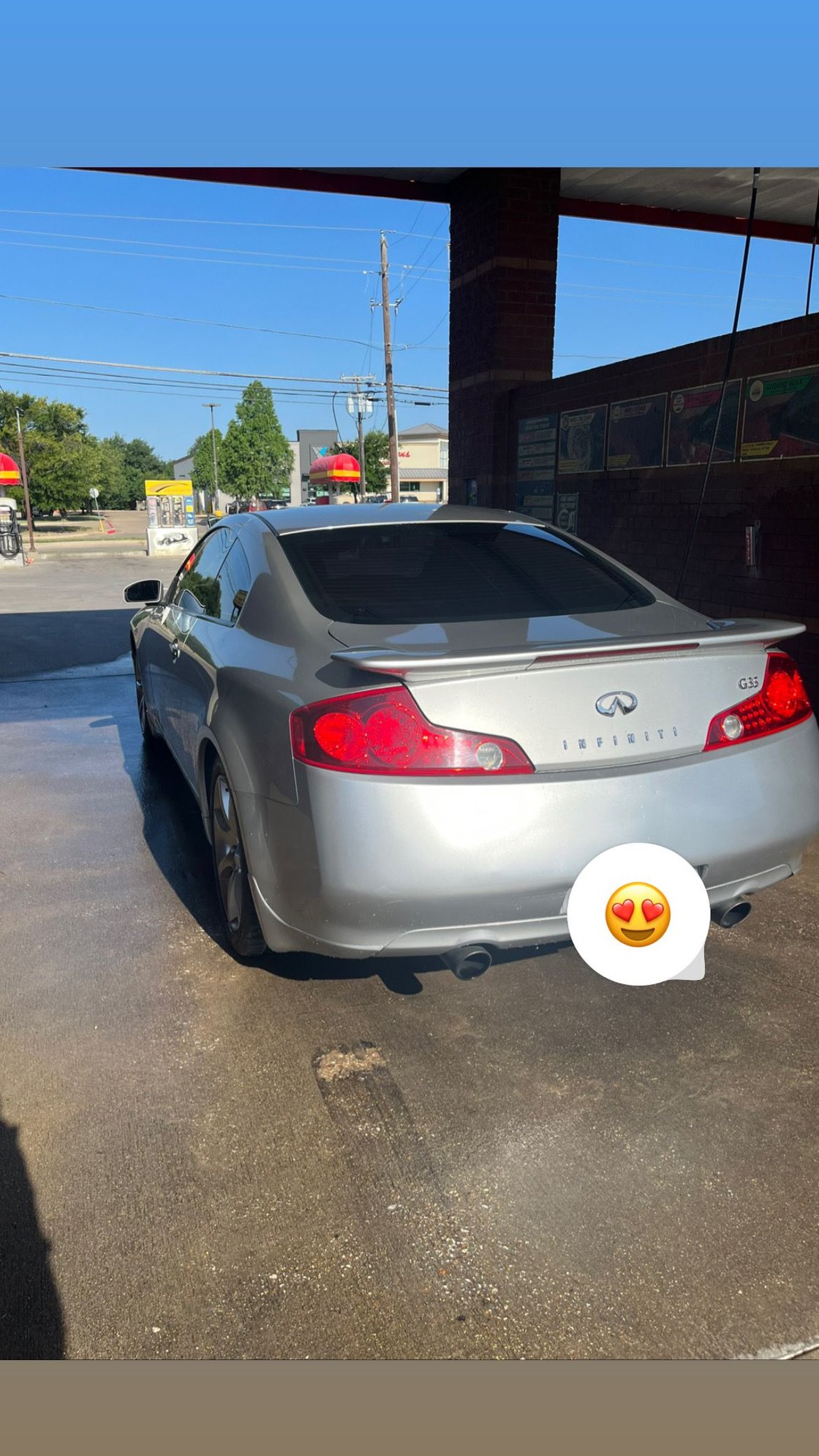

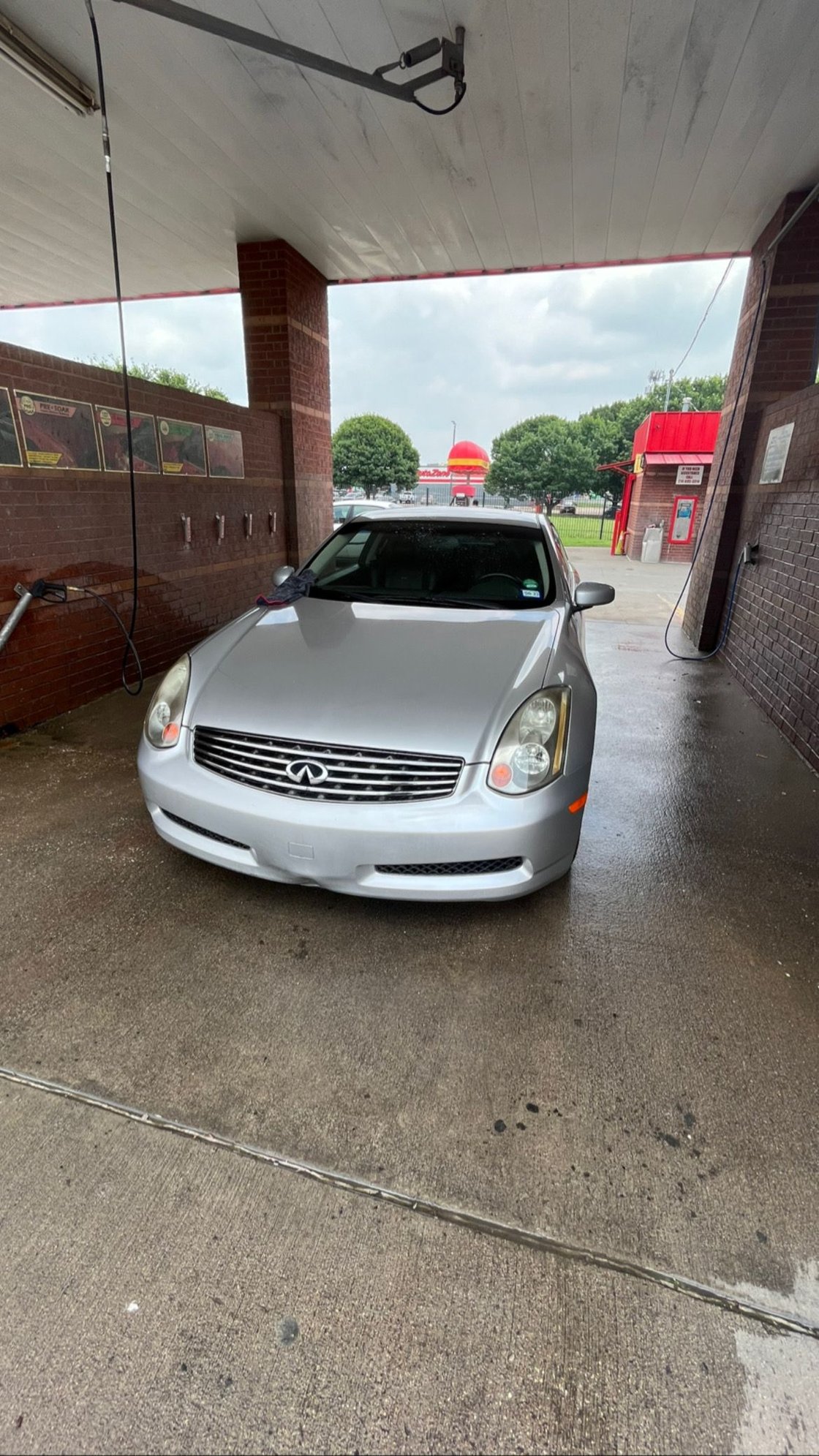

( just picked up my baby as well she’s mint for a 04)
