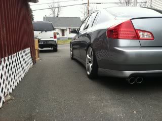

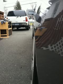

just added a 15mm spacer in the rear:
Lil more positive camber and it should be perfect, now time to test fit the front
