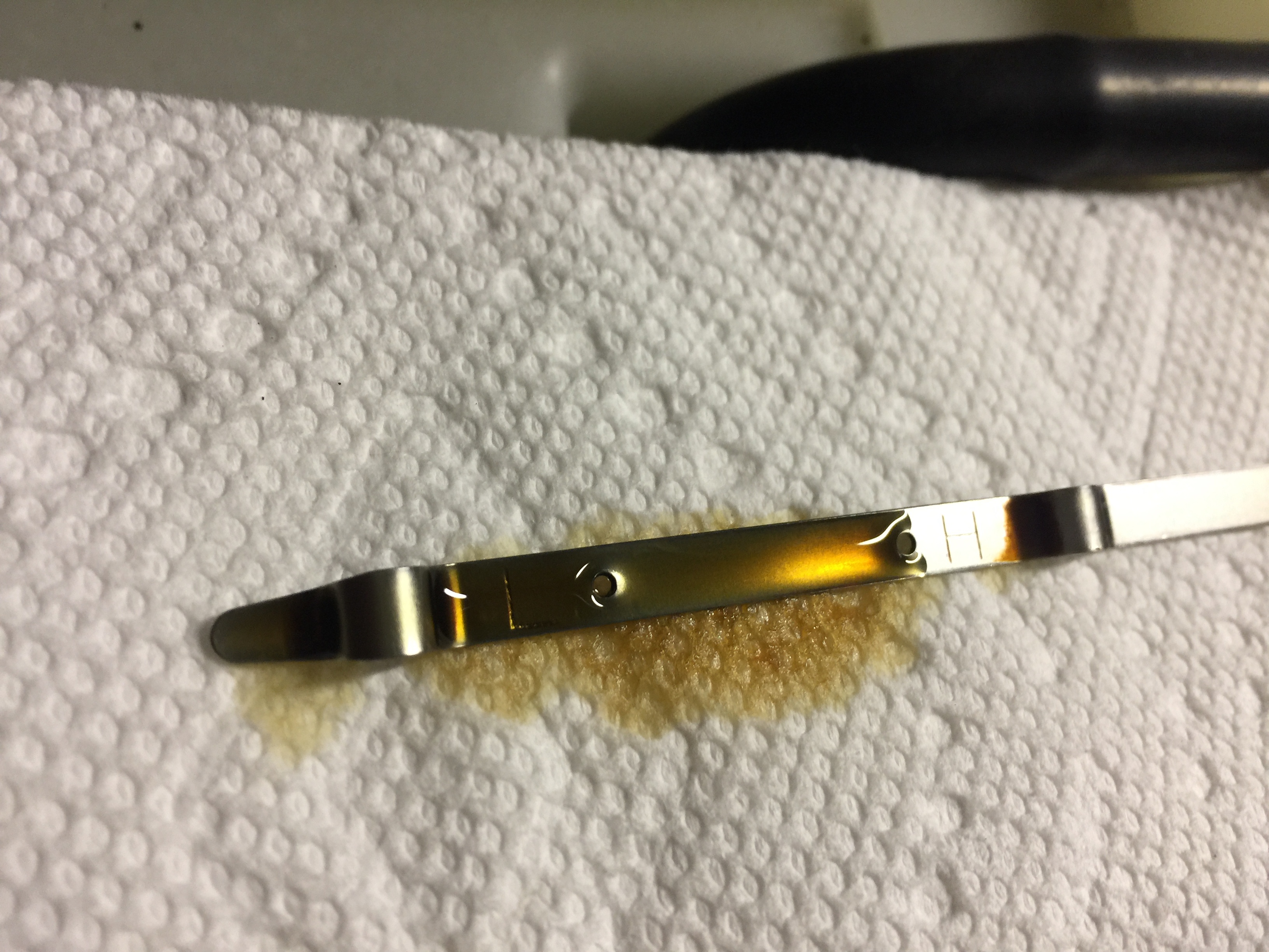

I think that's the '03-'04 dipstick, traditionally oil.level is ALWAYS filled to the top of the hashmark, the more volume in the crankcase the better, never fill to the middle of the hashmark.
That image is from the FSM for the '08 G35. The dipstick in my '08 has the "H" and "L" markings as well (see attachments). I've always read that you want the oil level right in the middle of whatever markings are used on the dipstick, be it "H" and "L", hashmarks, notches, etc, etc and anywhere in that 'range' is fine. If your car takes ~5 quarts but you didn't let it drain fully, that 5 quarts might push you towards the 'high' side but can be okay, for instance. You definitely don't want to overfill which can it to create bubbles (air).
Also, the oil on my dipstick flowed towards the "H" while I got my phone (camera). When I removed it, it was almost a 1/4" below the "H".
My apologies: I didn't realize this was in the '03-06 sub-forum. I've been reading, reading, reading and learning as much as I can and didn't pay attention.
Attached Thumbnails How to measure the engine Oil level-img_1304.jpg   How to measure the engine Oil level-img_1303.jpg
