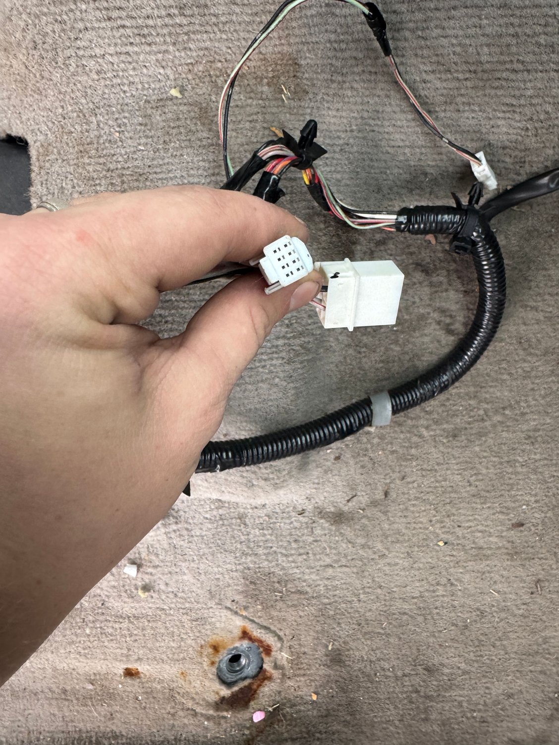

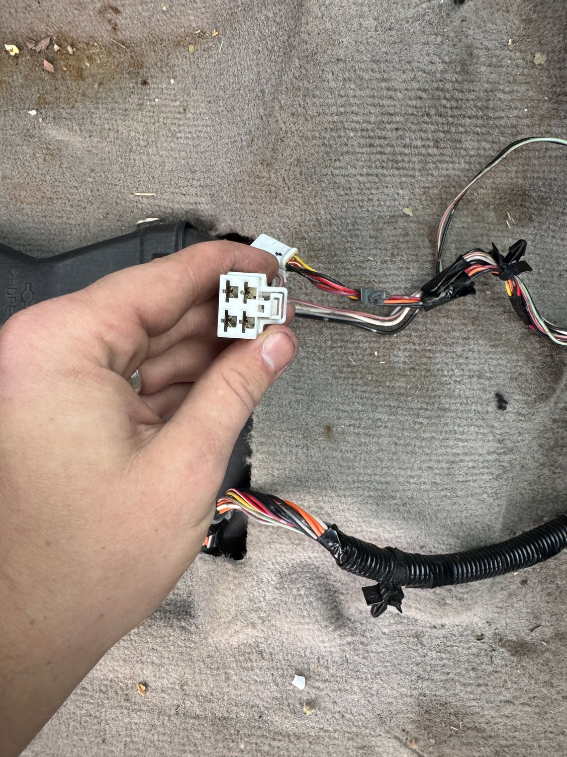

2006 G35 Sedan seats into 2006 g35 Coupe
Hey guys i know y'all started this thread when I was 1 year old but hopefully someone can help me. Im trying to swap 06 coupe seats into my 06 sedan. I can’t find any wiring diagram for these two plugs. The coupe seat i’m trying to put in has a 6 pin plug, I need help.

Did you download the FSM? It should have the pin layout in there.

Your subject line says sedan seats into a coupe but your message says coupe seats into a sedan. In either case, here are the manuals. Scroll down beloe the "viewing window" and you can "Click here to download a copy."
https://www.nicoclub.com/service-man...F2006%2Fse.pdf

Is this for driver seat? And does your sedan come with memory seat function? As far as I know the main harness connector should be 12 pin, where do those two connect to your sedan seat originally?
