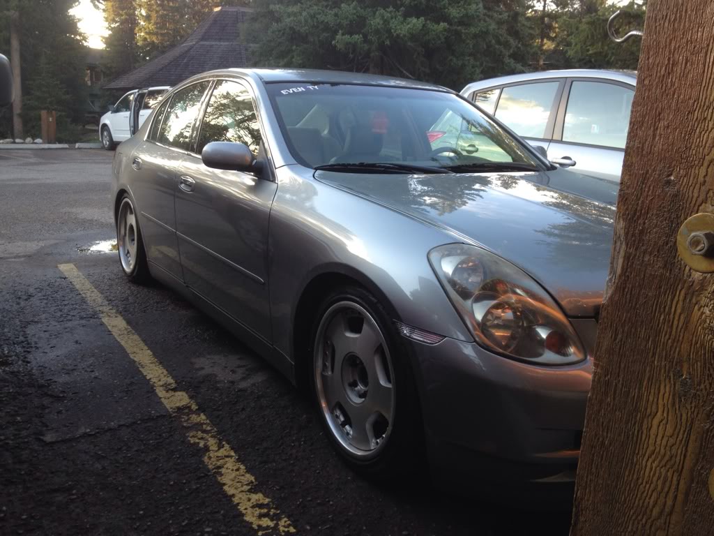

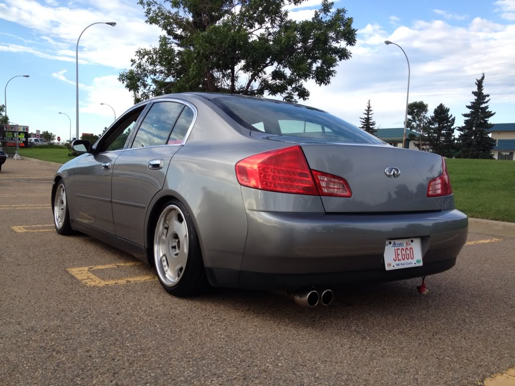

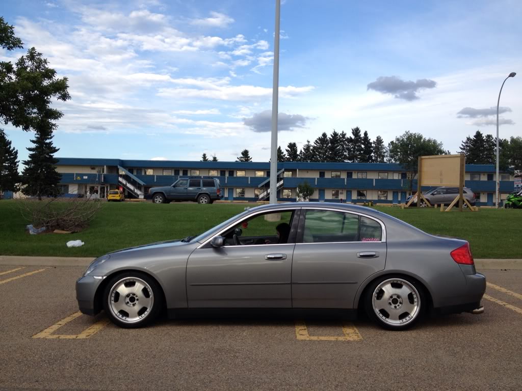

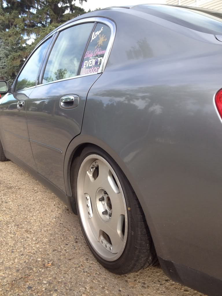

Question for you guys. I have stock non sport struts with sportlines for coupe springs. Here's how she sits now with 18"s
Now the questions, it is sagging I'm not sure if you can see clearly at the picture though but what are my options? I have a set of 350z springs and I was thinking of just putting the rears so it will bump it up a bit, right? Or just look something g lower for the fronts? Any recommendations? I can't afford coils yet. But that's my plan for the end of this year. I was also planning of buying a front n1 lip so I'm leaning towards dropping the front instead. Again, any suggestions for what will drop it more? Also, I'm kind of sunken now and don't know much for spacers but what do you think are the size I'm looking to buy here? Rims are +43 9" for rears and +43 8" for fronts. Looking to get more "flush" look hopefully.

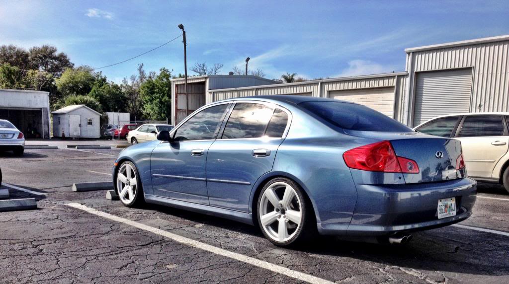

Eibach G35 Coupe springs w/ OEM sedan shocks. Not ideal, but FREE!
Wheels are re-drilled Audi RS6 wheels. 19x8 and 19x9, +30 and +22 (if I remember correctly, lol.)

^if you want the drop your looking for i would go with H&R lowering springs drops it -1.2 front -1.3 rear or Eibach Pro Springs drops is -1.5 front -1.8rear.. both about $300.
if you take the time to read through this thread you can find some picture of them on.
jeggo this could help out as well... and if you ad 10 or 15mm spacers would poke it out more. hope this helps.
