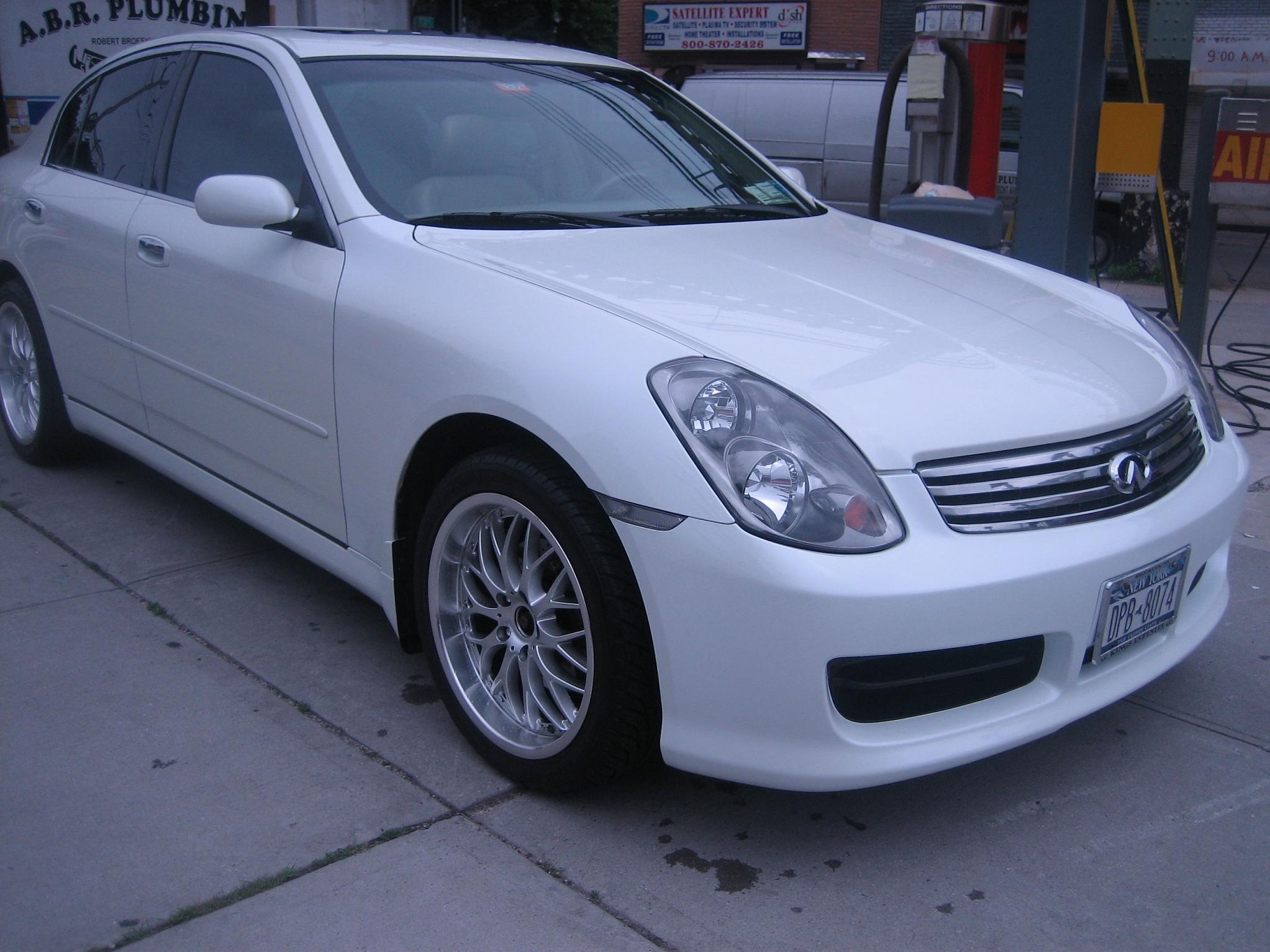

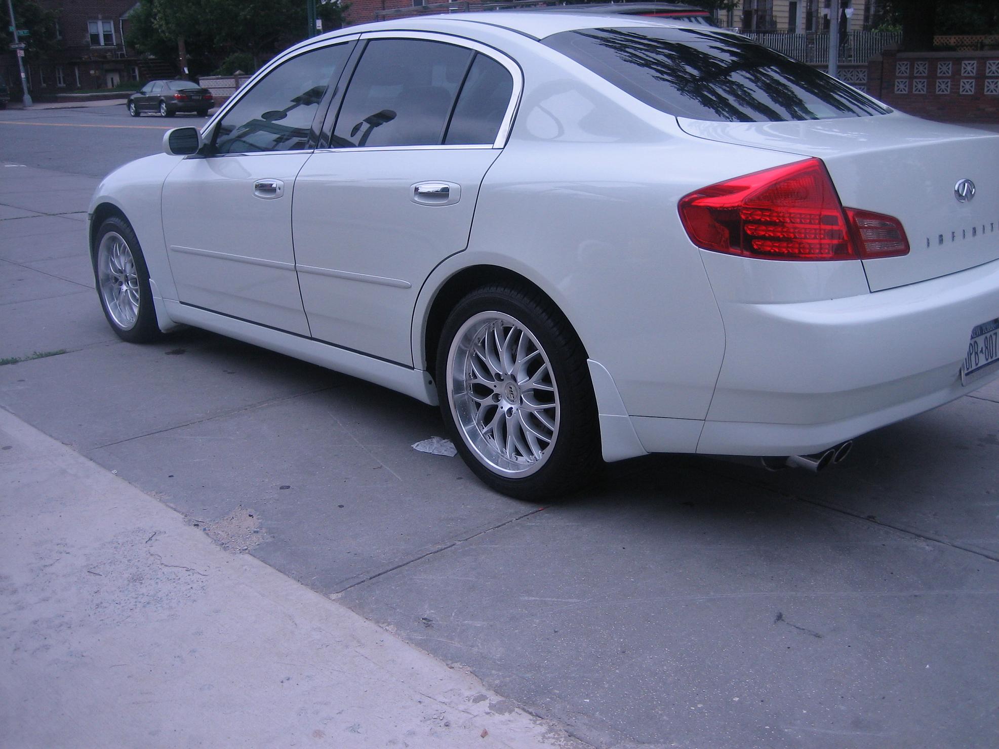

Whats up guys, I got my wheels road forced balanced to try and fix steering wheel vibration at around 60 mph, fixed the problem at this speed, but now i noticed vibration around 80-90mph. The tire shop installed hub rings as well, took it back so that they could re-balance them and still feel it a bit.
Can it be the quality of the tires that is causing the vibration? I have 18's with Nankang tires, I know these aren't the best tires around but they are basically new.
On a previous thread I stated that I couldn't put the caps on the front rims because the spindle is too long. Does anyone now where i can purchase a cap about 2 1/4" that will fit these rims?
