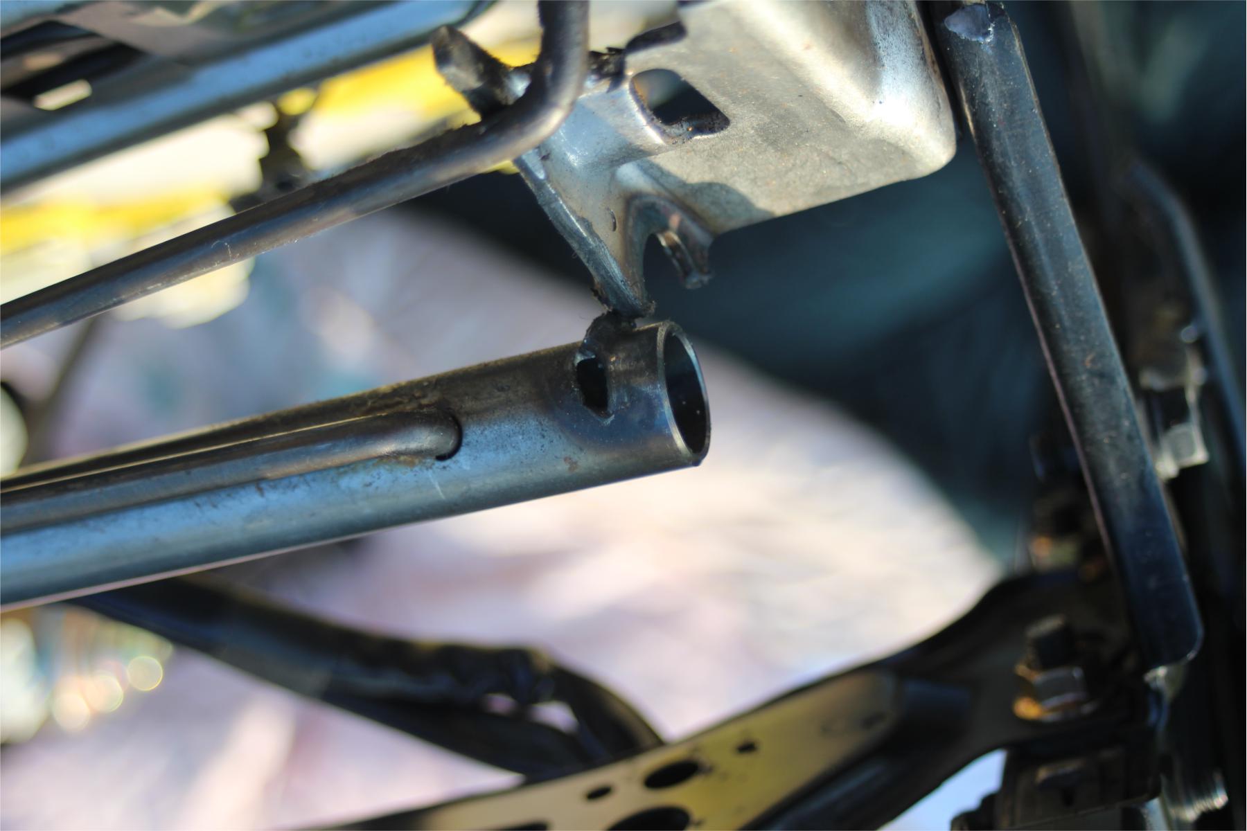

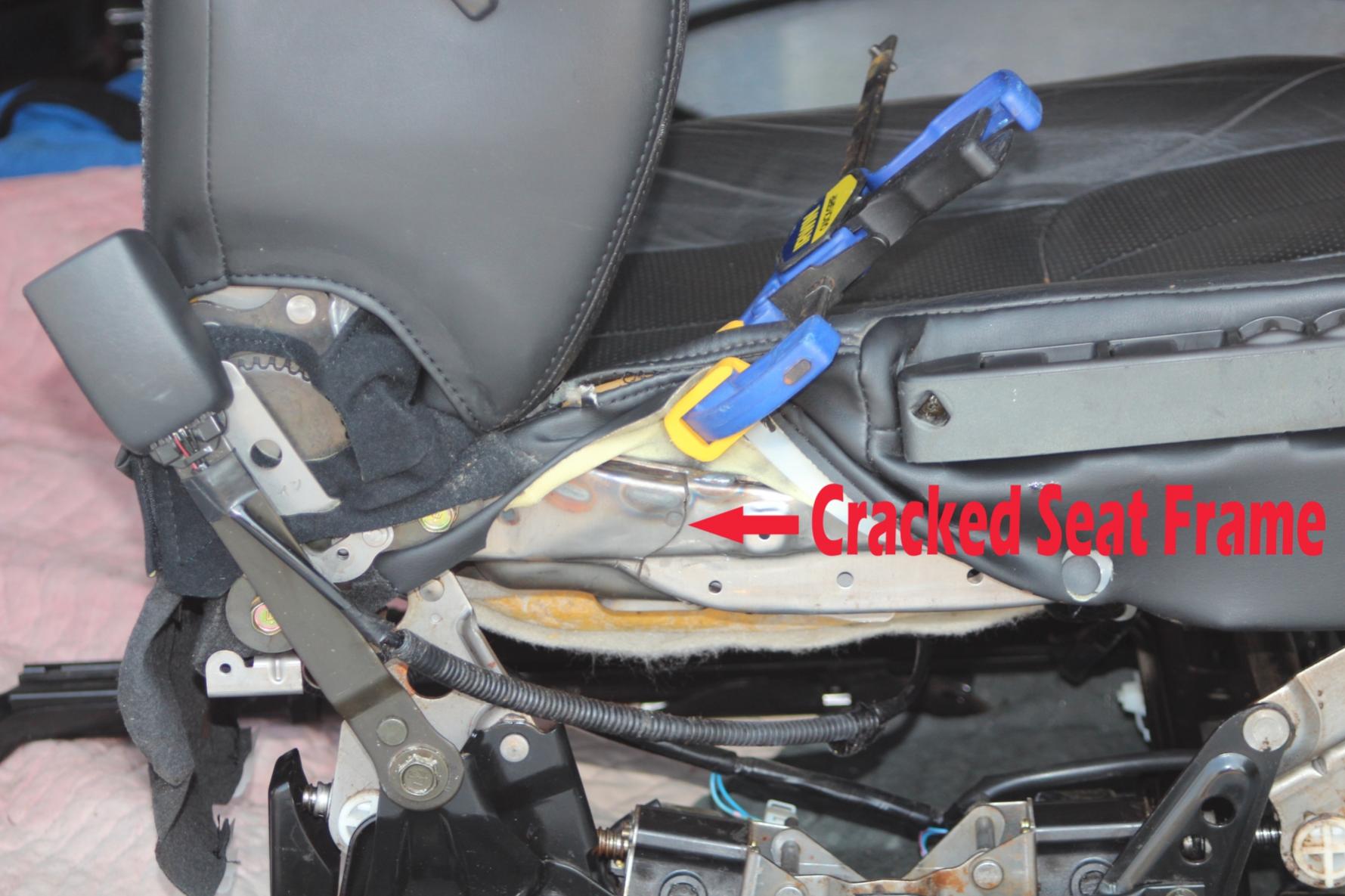

Just had my seat frame welded (car is still at the shop). My seat was pretty busted up so I hope the welds hold. Take a look at the destruction. I will post pics of the repair when I get the car back in 2 days.
