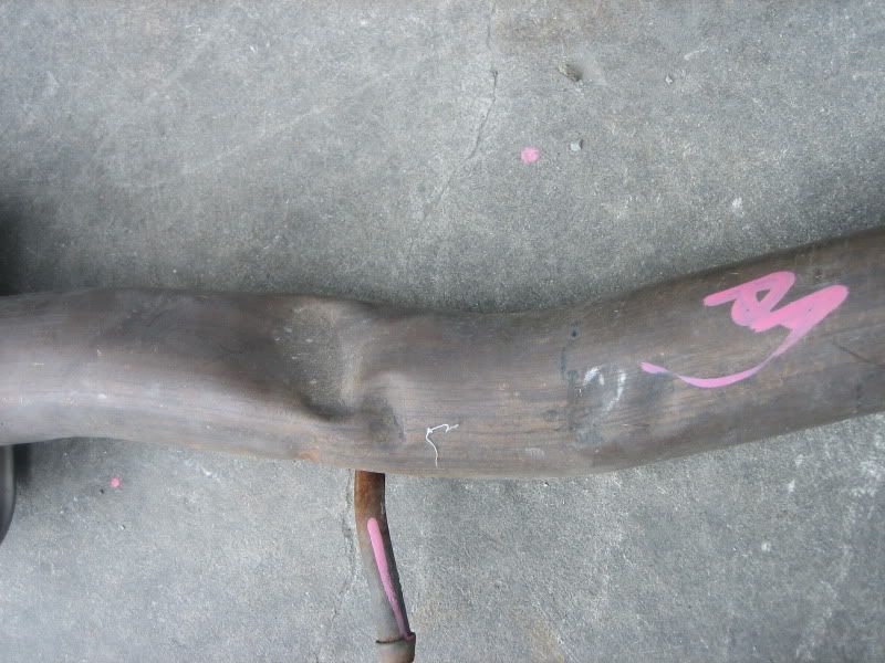

this midpipe worth buying? slightly bent
hey guys, i was wondering if this coupe midpipe would be worth buying, it was in an accident so it was bent from the tube. i just want to know if i should consider it or just wait.

i wouldn't buy any exhaust parts that are bent. defeats the whole purpose; the crimps restrict air flow.

No, Exactly ^ crimps restrict air flow 100%. Its trash now.

It looks like the crimp at the bend by the flange changed the direction of the bend. It probably doesn't even bolt up correctly.

OP, another alternative is to use part of your exisiting midpipe, delete the OEM reso, have a shop fabricate a mandrel bent piece and buy a new reso/pre-muffler. that's what i did. but it'll cost more than a used coupe middy.
