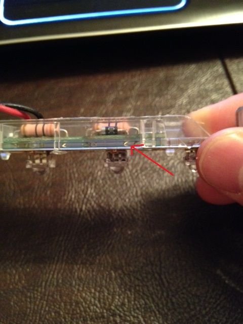

My third brake light was working off and on, so I decided to try and solder a new diode on. I got all the way to the last step, but this is my first time soldering anything electrical. My question is, how to I fully desolder the bad diode? I can get the solder on the front side of the circuit board, but the diode connection goes all the way onto the backside of the circuit board. I am not sure how to fully get it off. Any help would be appreciated!

Use a desoldering gun sometines called a solder sucker.
You basically heat up the solder with the iron and thrn use the solder sucker to literally suck the hot solder away. You end up with a clean board and loose component

Ok, thanks for the response! I've been trying with just a wick but the wick is probably a little too big for this job.

Solder Sucker- desoldering pump: Power Soldering Accessories: Amazon.com: Industrial & Scientific Solder Sucker- desoldering pump: Power Soldering Accessories: Amazon.com: Industrial & Scientific
Takes a bit of practice but since you already have an iron, this is the other 1/2 of the tool. You can also (carefully) melt the solder and then physically bang the board against a towel or something (beware of flying molten metal!)

Hahah if I get burnt with a little molten metal it will be well worth it if it fixes this damn brake light! I'll try it with the wick again and if that fails I'll go to radio shack and get a pump.

I am happy to say that the new diode fixed the problem! Thanks for those that helped.

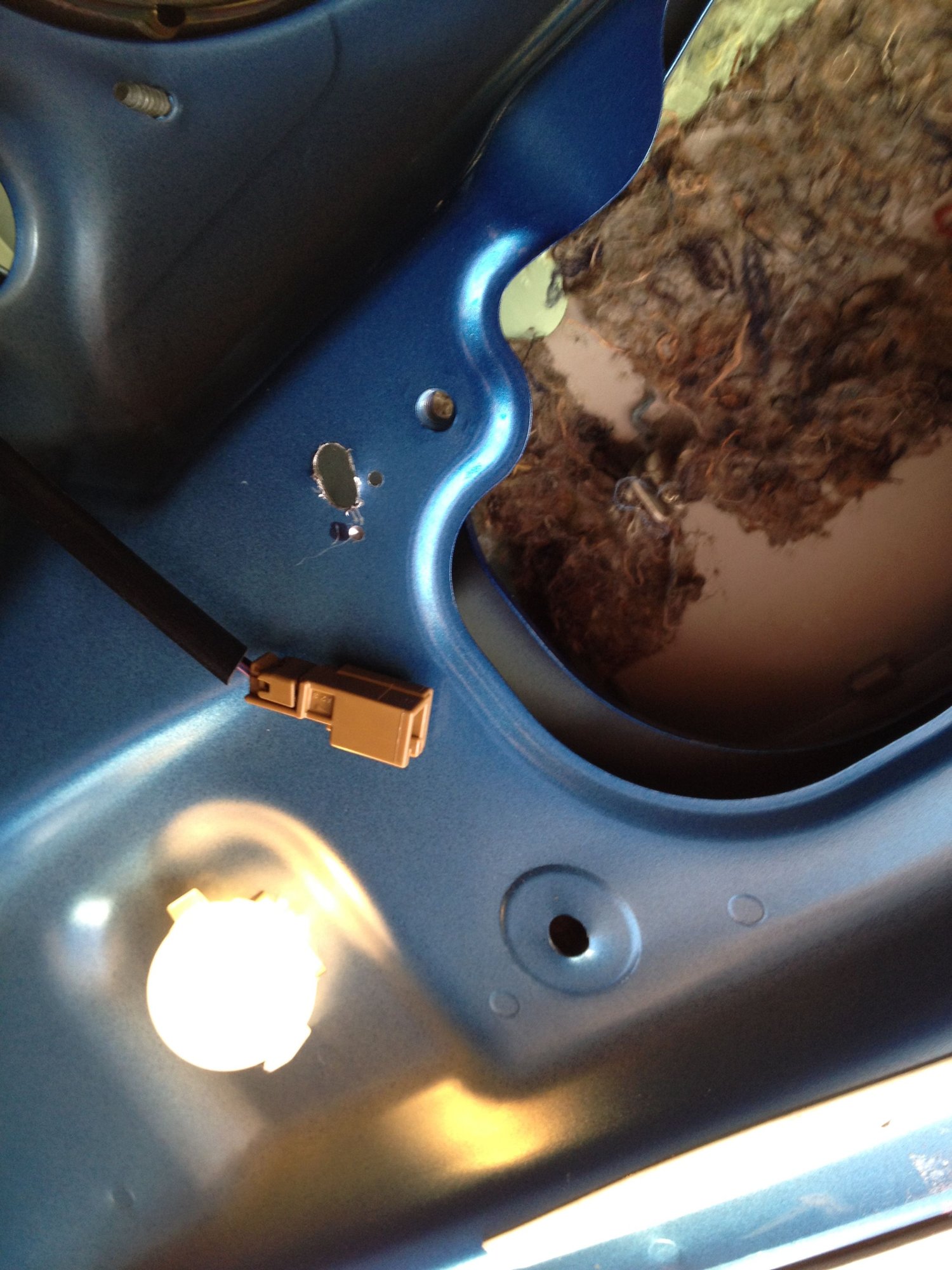

Just wanted to add some pictures for others that are going to tackle this problem.
This is where the screw goes on the driver's side.
Here you can see it took me two attempts to get the drilled hole to match where the screw is on the passenger's side. I was never able to put this screw back in, I haven't had any problems of the light moving around so oh well!
