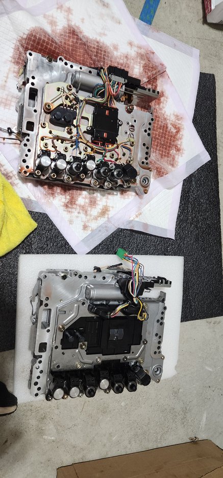

Question Transmission valve body questions 03 coupe
I have an 03 coupe auto, and i need to replace the valve body due to frustration searching for an issue. Was wondering if anyone new of where i could find one that isnt $1500, i new coming here was a stretch.
found a few on eBay. Search by the trans name perhaps? re5r05a valve body
I need one for my car specifically though I've ordered one of those and they are for a titan or the other model with the same Trans, issue is its not the same when it comes to the plugs.
Mines the one covered in tranny fluid. The other is one of the ones your suggesting

Buy a rebuilt Sonnax unit, they're as good or better than stock. Sonnax uses really good solenoids.
You can go to their website and look up the various RE5R05A valve bodies to figure out which one you need to order, get the part number, then order it through an online vendor like RockAuto, I think they cost $500.
Here's the page with the pictures and the part numbers.
https://www.sonnax.com/tech_resource...identification

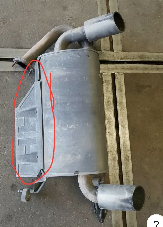

What is this piece in front of the OEM muffler for? Is it just a heat shield?

I looked for a bit and didn’t find anything. I can only think - AERO??

I looked at parts diagram for my 2006. It's part 20595-CD000, described as "insulator." So yeah, heat shield.

Good to know. Ive always wondered what its purpose was. I think mine is a little loose. Gotta see if I can tighten it up somehow.
