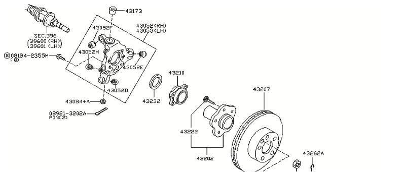

K so I had my car looked at again and narrowed it down to the bushing in the diagram below:
Any recommendations on what manufacturer to use?
Is that the lower "outer" control arm bushing?
Is this a good website to buy the part from?
Mynismo
Do you guys think I should replace other bushings too?
The mileage of my vehicle is 100K.
Endlinks need to be replaced to.
TIA
Mynismo
TIA

K so I've tried to find out more on the rear bushing that I need.
Its labeled part number 43052F in the attached picture.
From what I've been told is that I need to change out the entire assembly (Part number 43052 RH) and that way I will be able to change 4 bushings.
My question is there a kit that I can buy for these bushings that are aftermarket but offer the same or exceed the ride quality and durability of oem bushings.
Is it better to change the LH side also?
Should I buy the OEM PArt for both sides (eac his around 225 I've been told) or go with the aftermarket bushing kit.
Sorry for all the questions but I've been trying ot look for an answer and the fact is I dont know a lot about this car suspension and am trying to learn as I go along.
UPDATE : Found this link on sewell:
http://infiniti.sewellparts.com/oem-...edan-2005.html
What do you think? They are selling the bushings separately.
Thanks
Thanks
