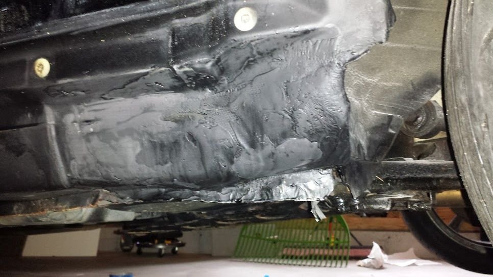

My car is also rusted out in the same locations, I was quoted $1700 from a body shop to repair. This weekend I'm going to be attempting to fix it. Planning on taking lots of pictures of the process and posting them here.
Have you ever taken off your side skirts? You might be surprised at what's hiding under those, and not in a good way. Here's what mine looked like before I started grinding.

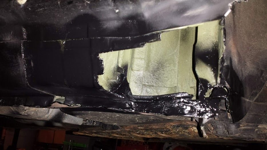

I've already stopped all the potentially structural rust. Here's what that hole looks like now:
Black is rust converter, green is Eastwood internal frame coating. All metal inside and out is completely 100% solid now.
Inside the panel is 100% clean now
I've had it covered up in duct tape to keep water out, and it hasn't changed in months. I consider my G "structurally" rust free but the rear quarter panels are still falling apart around the wheel wells which I'm going to chop out this weekend. Yes, buying a clean car would be a whole lot less work, but this is what I've got, it's reliable, and its sorted.

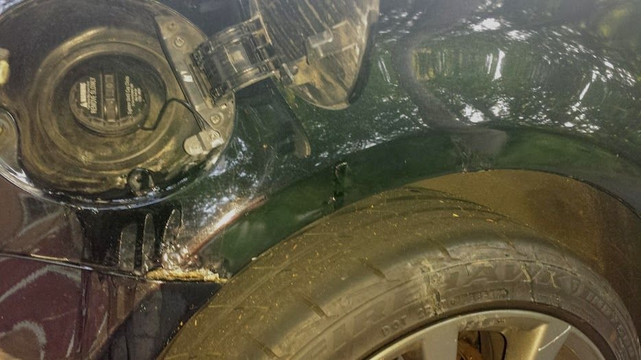

This is most of the cancer that's left. That dripping stuff is rust prevention gel I've been injecting into it to slow it down.

Giant hole... ugly but completely sealed behind layers of fiberglass. Now covered in paint and soaked in fluid film.
Rust cut out with grinder, inside of panels run through with sandpaper, cleaned and painted with converter to get as much as possible.
nearly finished bondo work before primer and temporary coating
How she sits (almost) ready for the daily winter commute. Those headlights are GONE
It was cold out by the time I finished the repair so I just covered it all up in primer followed by black Plastidip for the winter.
Come spring I'm going to peel it off, see how the repair is doing and touch up if needed, and send it to somebody to get the final finish looking decent before liquid dipping my whole car to make future repairs to the area much less costly.
