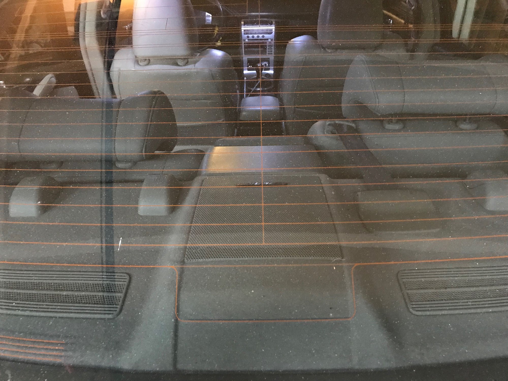

I inspected further this morning. Here is what the rear shelf looks like:
It doesn't seem like anything was there previously; in person there isn't any discoloration of the material like you would expect for an object that was on there, any wear marks of removal, ect...

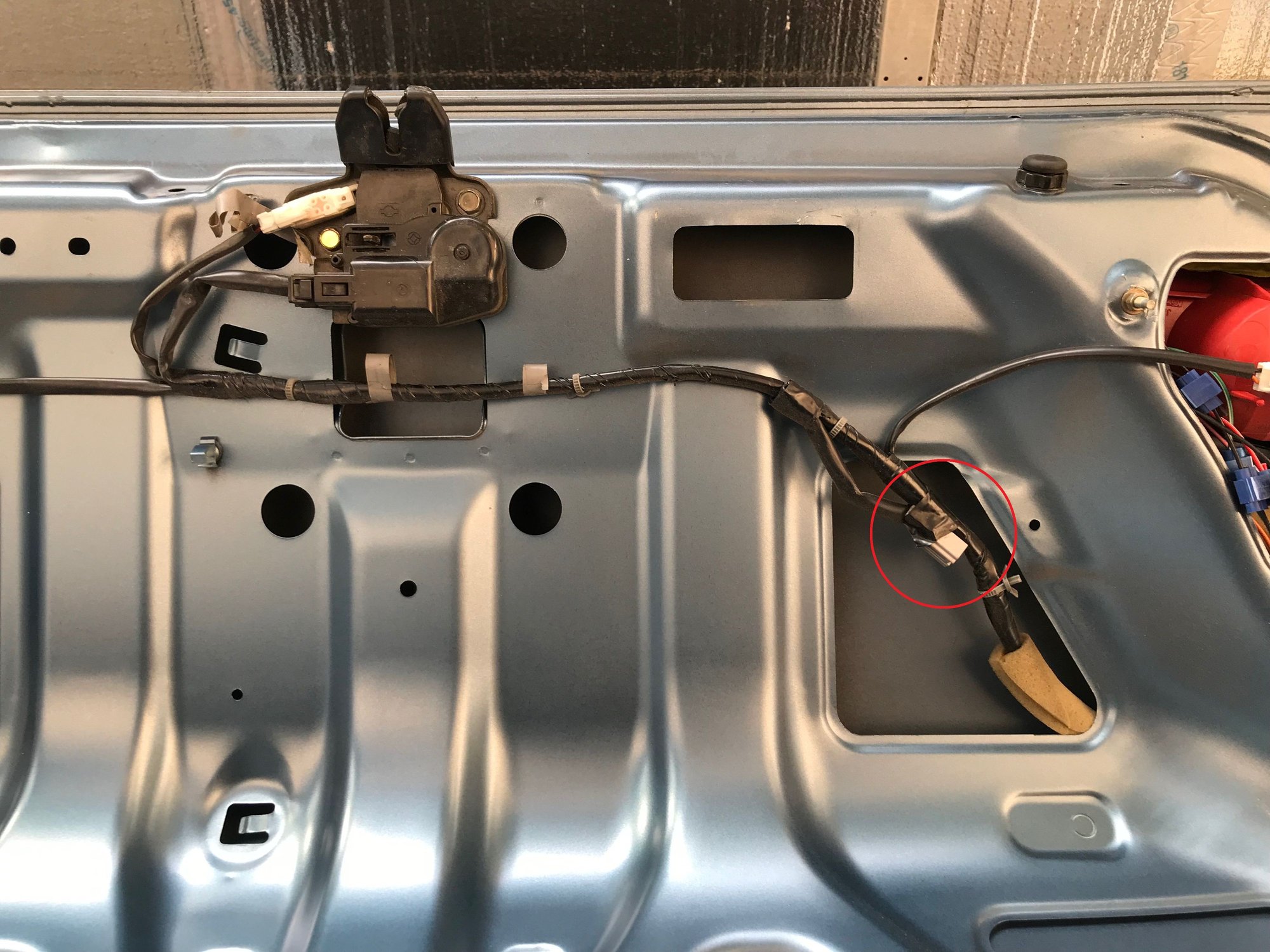

I also removed the trunk liner to see if there was anything else. Aside from the fact that I do not have one of those interior trunk handles, I did find this an extra pigtail. Might this be for the spoiler brake light?

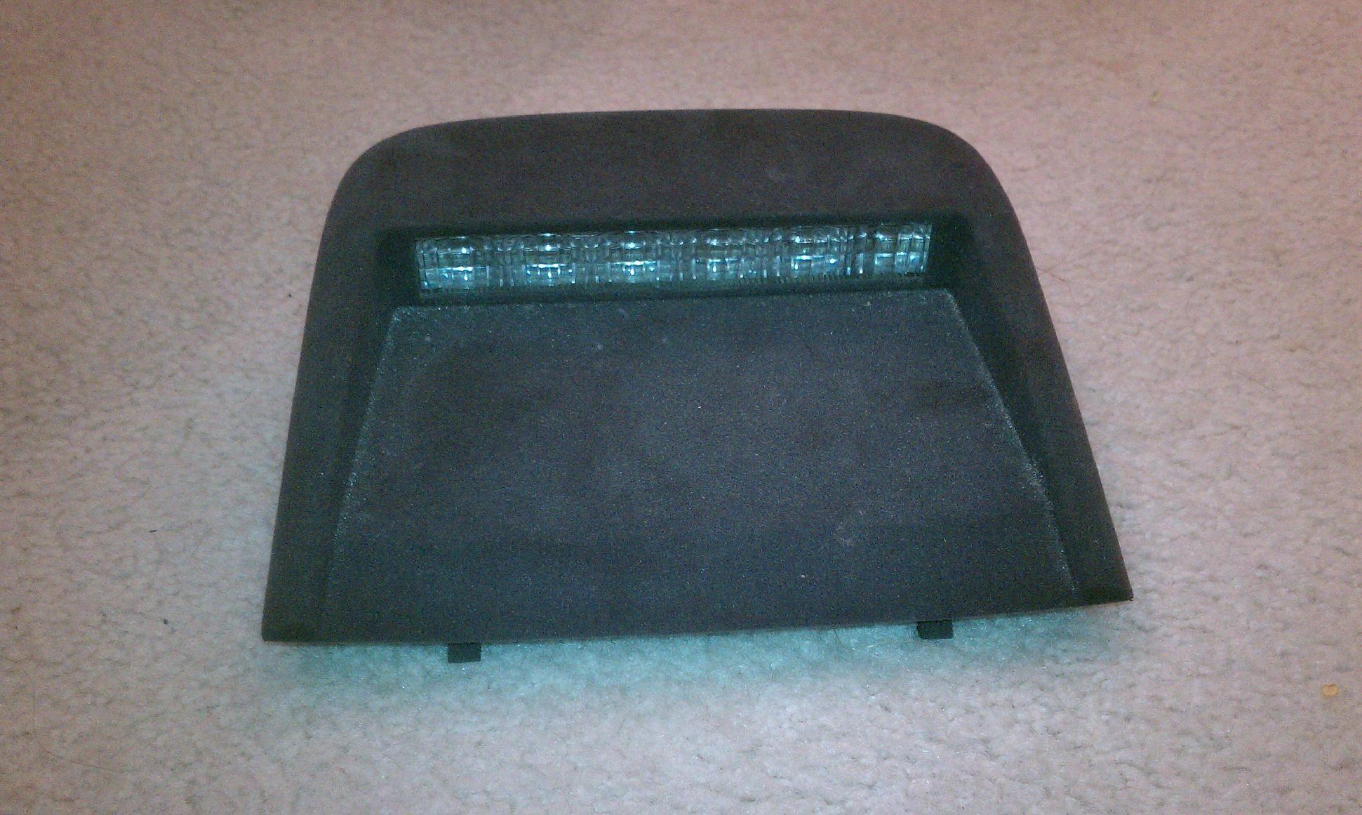

As a side note, does anyone have a link for where I can pick these up:

There were many variances of these cars that all affect this area for example:
Reclining seats or not
Bose option or not will change that speaker area
FACTORY from THE FACTORY equipped spoiler cars DID NOT bring this light as the spoiler gets in the middle and can look weird and this appears to be the case.
It looks like your rear trunk was replaced with a non spoiler edition or the previous owner deleted it.
For those that have a third brake light along with a Spoiler it means your car did not come with this and was a dealer installed option.
The correct way would be to order the non 3rd brake speaker area cover however this would add an extra 5 hours of labor and hundreds in parts, when all you wanted was a spoiler, your average consumer would never notice this and the dealer would "use the you can never have too many brake lights" excuse.
To add it you would have to buy the speaker area cover with brake light and the issue is most of these lights burn the resistors since they're LED. You could buy an OEM spoiler and plug it to the existing harness since it has that option.

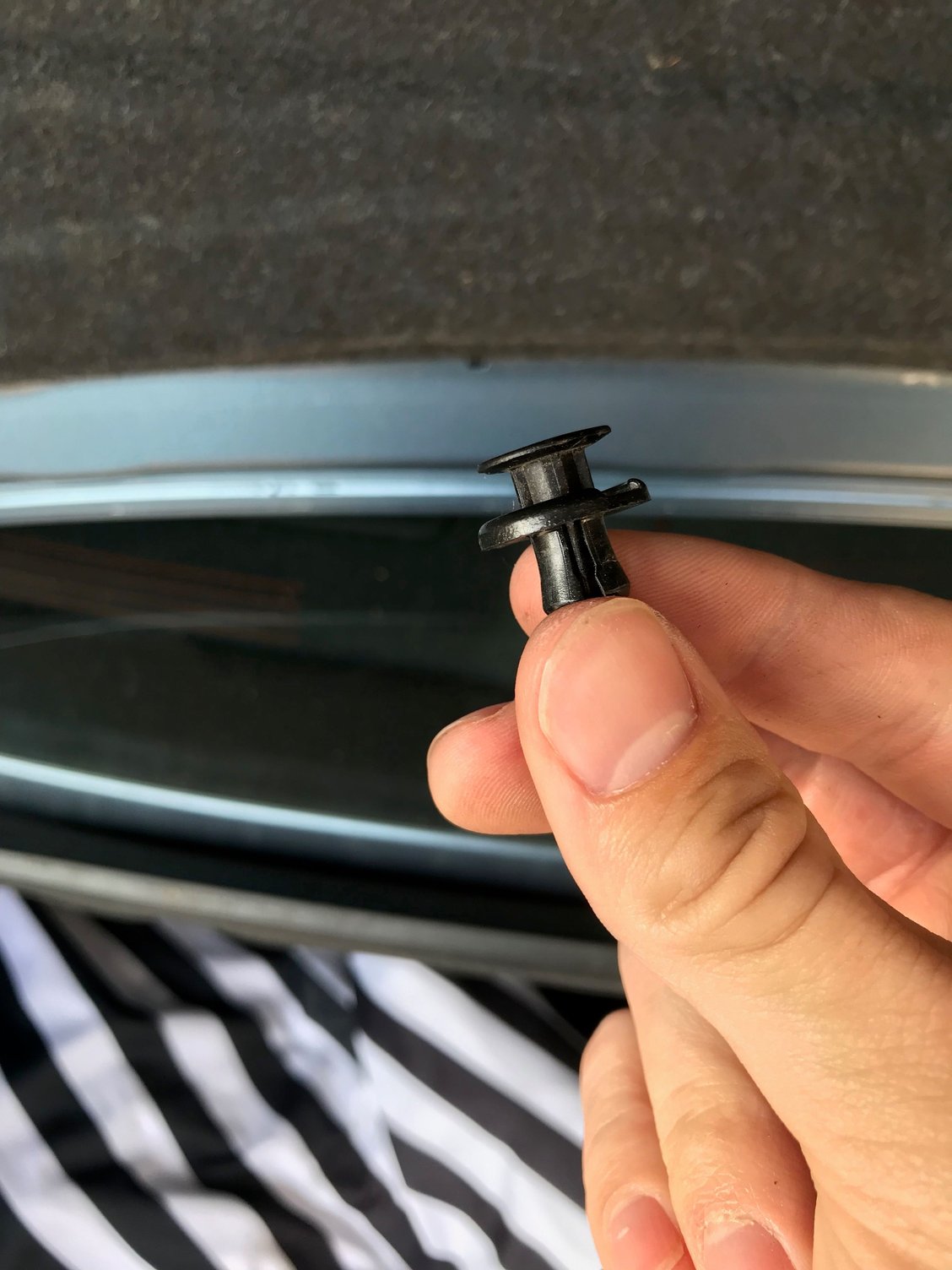

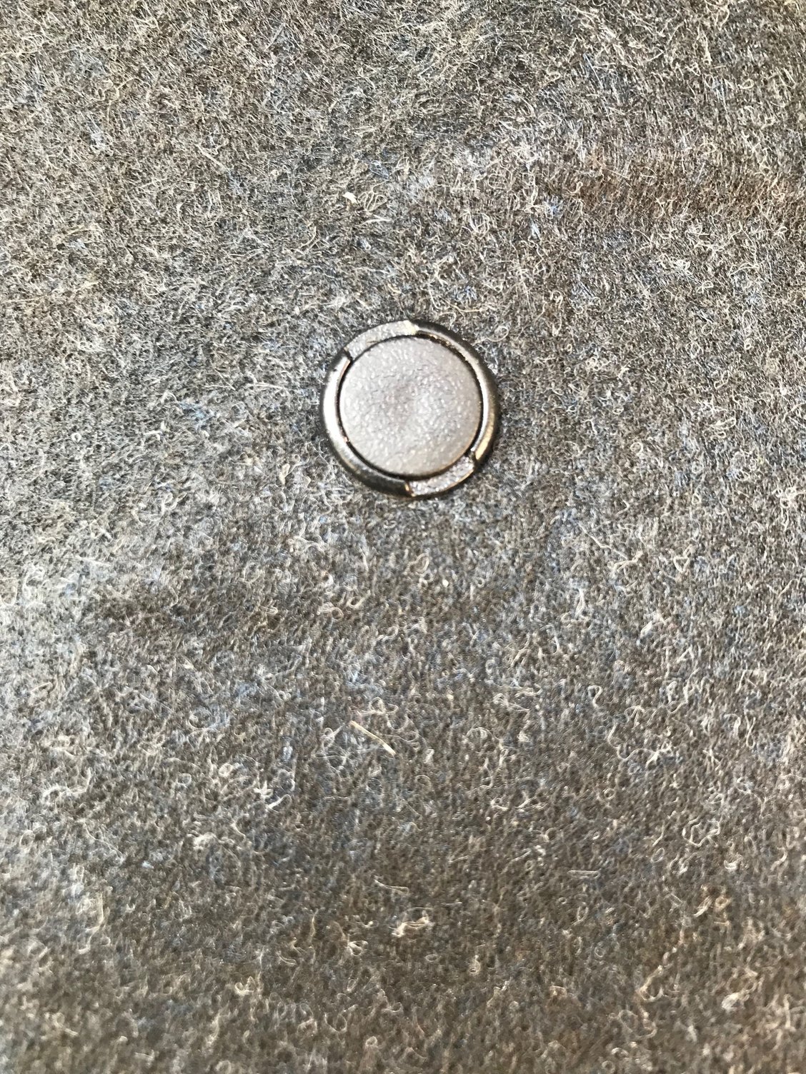

Thanks Bull, that's what I hypothesized last night. A few things indicate to me that this car may have had some damage in it's life:
Pop rivets missing from trunk
Spare tire/jack/tools are gone
Rear license plate light bracket is gone (Like, the whole thing. There is a light way back in the bumper but it isn't very illuminating)
Trunk lid replaced with non-spoiler, but the wiring harness is still there. On the off-chance they kept the original trunk and just removed the spoiler, you'd think you'd see something there to indicate the holes were filled.
