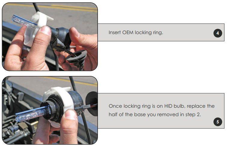

Grabbed all of this but I'm currently completely baffled as to how I can get it into my car. Plugs don't match. Wires don't match. I'm puzzling over their installation instructions, but they refer the "OEM locking ring," which ... is a total mystery to me. I don't know if I ordered the wrong thing, missed ordering some key parts (e.g. "OEM Locking Rings") or just underestimated the amount of re-wiring, etc., that this is going to require.
That doesnt look like a regular DDM bulb. But good to hear u got it all workin again!
