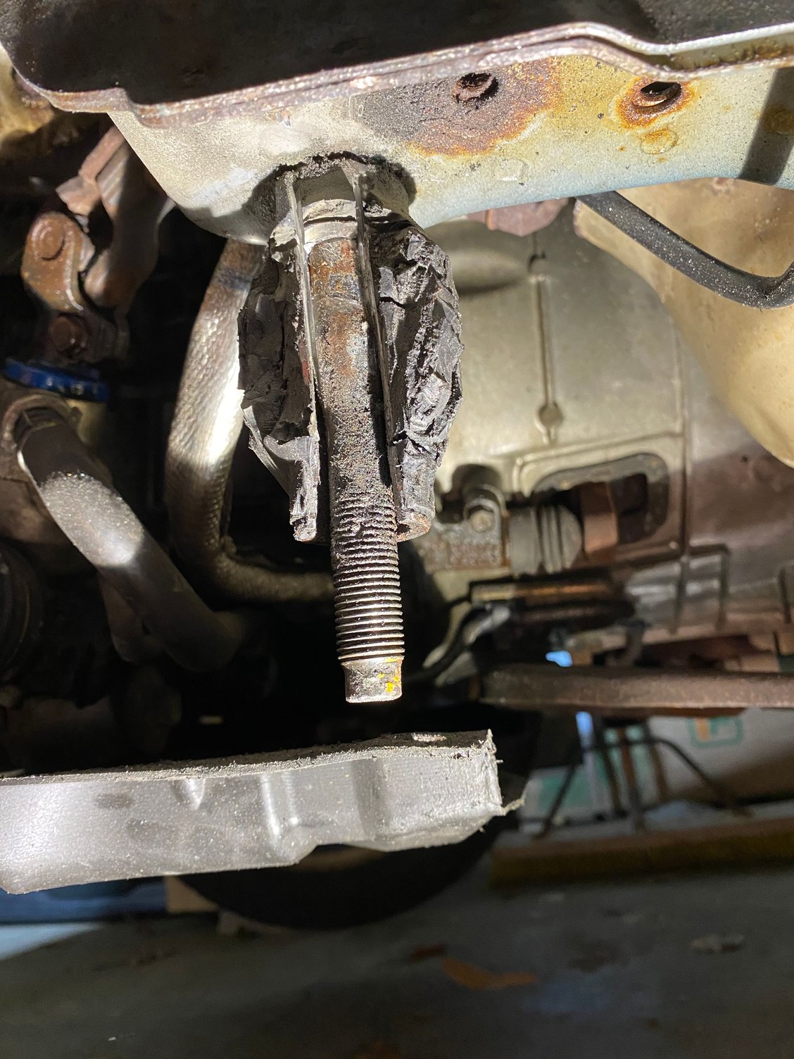

The aft compression rod bushing was the nightmare-fuel. Under normal conditions (as in the video above), once you remove the two nuts holding the front and rear of the compression rod, you should just be able to hit it with a hammer to knock it loose. As described in this post, what can occur (and what happened to me) is the inside sleeve of the bushing can rust-weld itself to the frame and the stud. No matter how hard you hit this compression rod, it's not going anywhere. I attempted to use a jaw puller to remove the bushing, but this did nothing more than ripping the bushing away from the rod (which, after removing the bracket shown in the DIY post I found the bushing to be slightly ripped anyway). This is what it looked like:

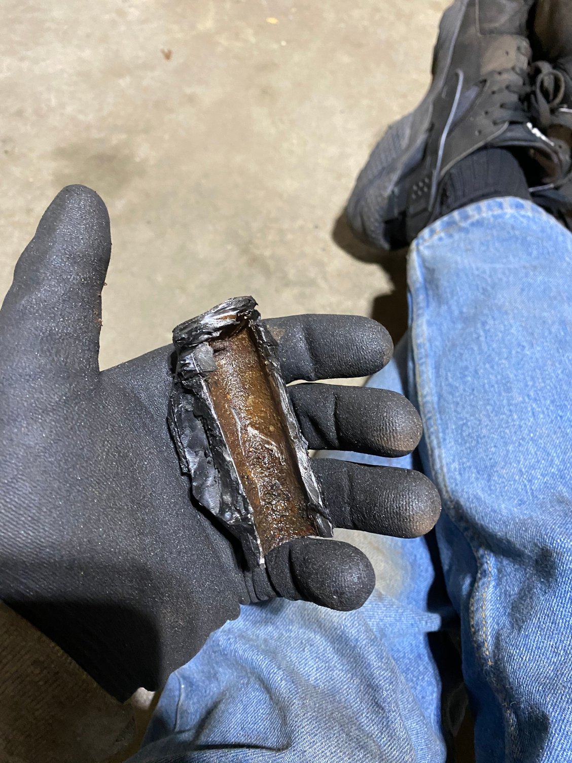

From here, I used a drill to completely detach the rubber from the stud and compression rod, which allowed me to remove it and get better access. A flat head and hammer removed the leftover rubber from the metal. Using a Dremel with a metal cutoff wheel, I made three cuts through the metal sleeve of the bushing, but taking care to avoid heavily marring the stud. As mentioned in this comment, removing this stud is almost a death sentence for the car. The goal of these cuts was to cut out a piece large enough for the stud to pass through the metal sleeve sideways. The rational behind this was that I would be able to apply enough lateral force to break the rust on the base of the metal sleeve, and from there I could pull it out. Here was the result:
As you can see, the stud is tapered. I actually made a bunch of very small cuts, taking out a piece at a time until I reached this stage. From here, I made my best effort to cut as close to the body of the car as I could to try and make the base of this metal sleeve week. I would cut for a bit, spray with penetrant, hit with hammer and chisel, spray, and hit again. Eventually, I was able to get the sleeve moving, and it was a matter of back-and-forth movement to break the rust and remove the sleeve. Here is what it looked like afterwards:

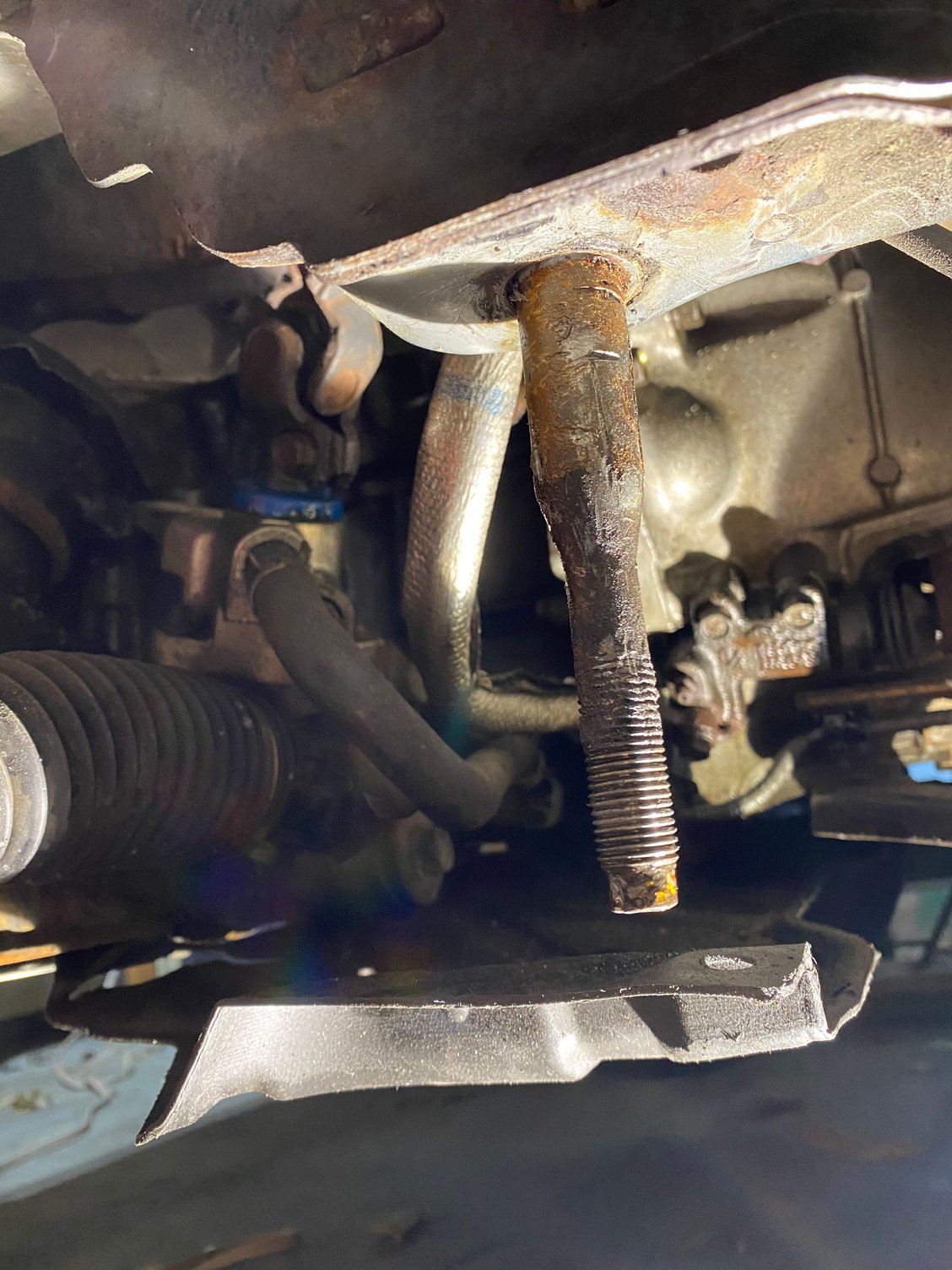

and the stud:
There were a few cuts in the stud, but nothing that would compromise it too heavily. I used some sandpaper to remove the rust and debris from the stud, and then I used some copper-based anti-seize on both the stud, as well as the top and the inside of the new metal sleeve so that next time this job is easy. The installation of the new compression rod was fairly straightforward: I put the new conical bushing into the hole for the ball joint, fastened the ball joint with a new nut and new cotter pin, then jacked the knuckle up to align the rear bushing, followed by a couple mild blows of the hammer. while the car was on the ground, I tightened everything per the FSM (59-79 ft-lbs for the ball joint, 80-93 ft-lbs for the aft bushing, and the other two bolt holding the bracket to 45-51 ft-lbs).
