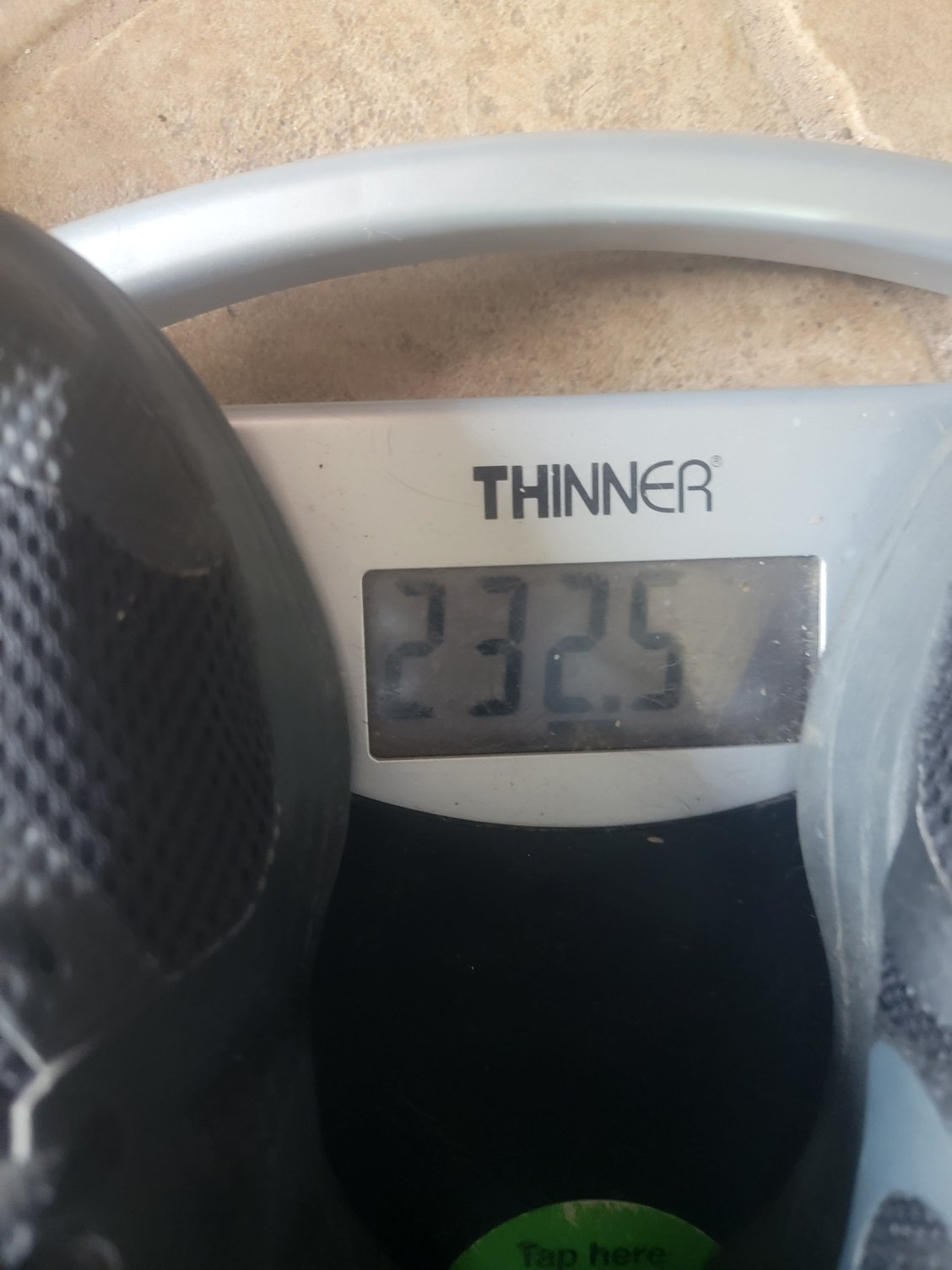

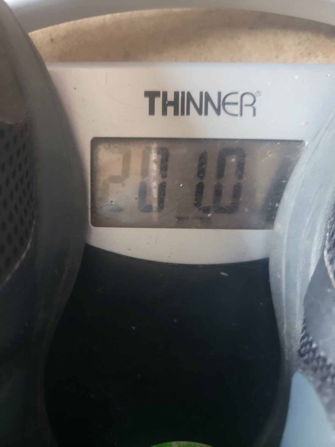

Recently decided to purchase an aluminum drive shaft for my sedan.
Good news it fits perfectly!
On my quest for rotational weight loss I have found that it's 15 lb lighter then my 2 piece... Almost half the weight. Also you get less drag resistance as the two-piece has that bearing. Aluminum driveshaft is 16.5 lb. Two piece drive shaft is 31.5.
With a lightweight flywheel. And z1 crank pulley IV saved 37lbs total off my rotational Mass and body weight.
Also bought rays wheels and Michelin sport cup 2. Compared to the steel wheels I lost another 5 lb off of each corner. Grand total of 57 lb of rotational mass weight loss.
When I get home tonight I'll post some pictures hopefully of my scales with the actual weight of the driveshafts. Hopefully this is freed up a lot of torque. And has made this sedan alot quicker.
Edit added pics of original body weight then weights of each driveshaft.
