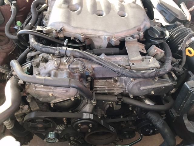

Hey everyone! Please help, I’m needing to get “Baron” back on the road after this JDM swap.
“Red Baron” History: 2003, G35, Sedan, 201K, AT, Rear Wheel. Been in the garage sitting with old engine bolted on after warping a head cruzing to ABQ. It has had no battery in it the past 5 years. Bad I know, but engines cost money and I refused to scrap it because it was awesome!
Problems:
1. It won’t even crank or start after JDM engine & tranny swap.
2. OBD II won’t connect or pull codes
3. The insidetemp gauge reads -22?
Work already completed:
1. JDM Engine and tranny hooked up to OLD wire harness and ecu (since the jdm harness was cut and no jdm ecu). The front end is still off with the radiator and headlight connectors not connected since we tried to crank and start as a test before putting it all back together.

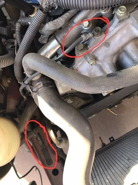

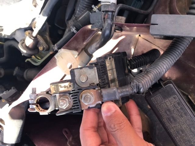

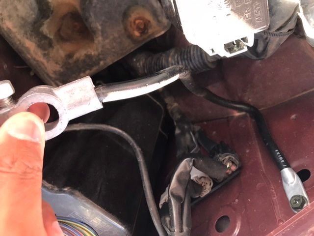

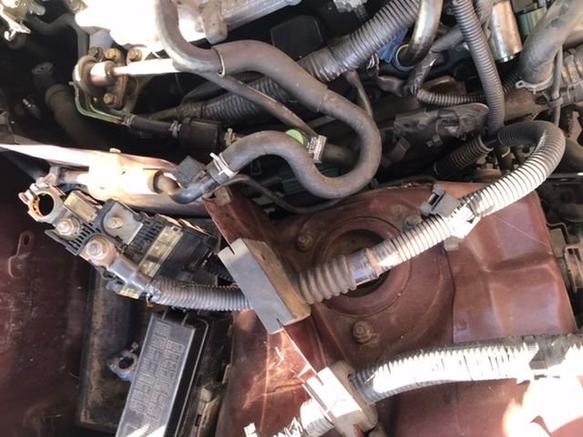

Hey Cleric, thanks for the reply. Sorry, your reply went to my junk mail and didn’t see it until now. I went through your recommendations, when I went to crank it the red security light stayed on. How do I get it out of lock mode?
I tried turning the key to ON for 5 seconds and off for 5 seconds multiple times per the Inifinit manual but same results. I had a key reprogrammer come out, they connected to the G35’s OBD port, received power from the OBD but couldn’t connect with the system. I’ve tried connecting an OBD scanner to it as well, it receives power but doesn’t connect to the vehicle. Could this be because of a bad ECU or bad OBD port?
To answer your other questions, the IPDM relay does click when trying to start it. Also, I’ve enclosed pictures of the grounding wires to see if there is something I’m missing. Tested those connections with a ground light and everything lit up.
Can’t see but positive terminal connected to starter and alternator underneath
Negative battery terminal
