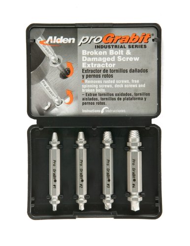

so after I finished installing the Takedas, I put on the OEM engine cover and tightened all the corners then the center. Couple turn of the wrench and I feel no more resistance...the bolt snapped off at the head. WTF! Is this something I can remove myself, or do I need to take it somewhere? ive taken out stripped bolts before on my hockey skates and have a dremel.

great to have around ..

i have those! lol! Didnt know if this would fit or not.

the grab it should work .. or you going to need a professional left handed drill bits and extractor set
http://buy1.snapon.com/catalog/item....&group_ID=1254

Also you can get a drill and a left handed tap. I had some ****ty bolts in the shop aI cold not take out with anything else but drill a hole and left handed tap. We have all kind of taps and drills in my shop handy. After all that's what we do for living. LOL Worked like a charm.
Most of the time if the bolt isn't tight you can unsrew it with a little puncher.
If it is a thru hole I just usually use a smaller drill and drill it from the other side. It unscrew itself when you drill it. But that's not the case with you.
Can't you grabb the screw with wise gripps? Is it sticking out or not?

The head is not sticking out. it broke off about 1/8th of an inch below the surface.

did you try the grabit ?

alright, tried it and success. the grabit is amazing!
now I need to get a new bolt...is this something I should grab from the dealer or just any lowes?

I used a "grab-it" a few weeks ago and the tip of the grab-it bit broke off in my bolt I was trying to get out. I tell you, try getting out a tip of a tool steel bit embedded in a bolt head. Impossible.beathorse
