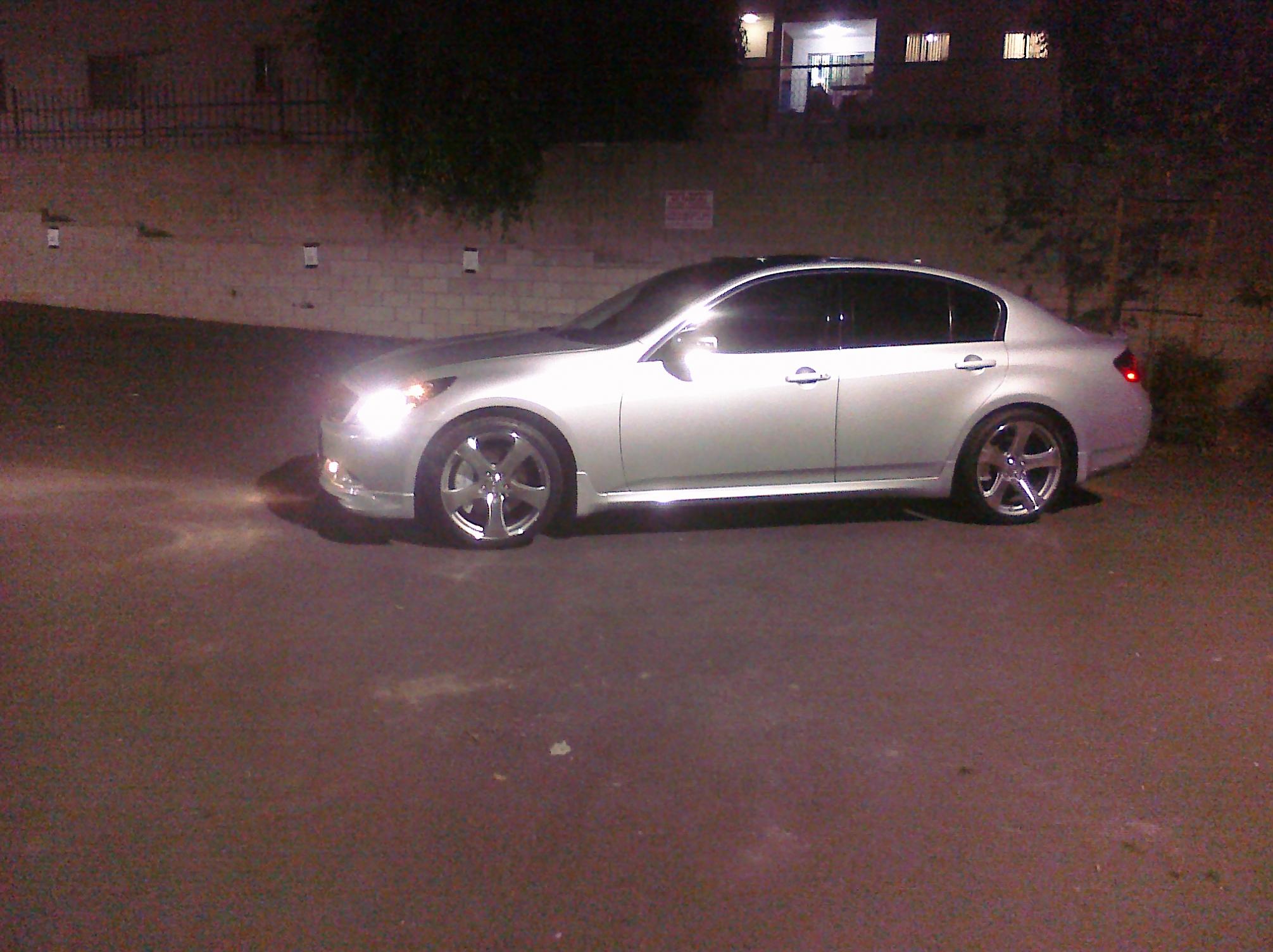

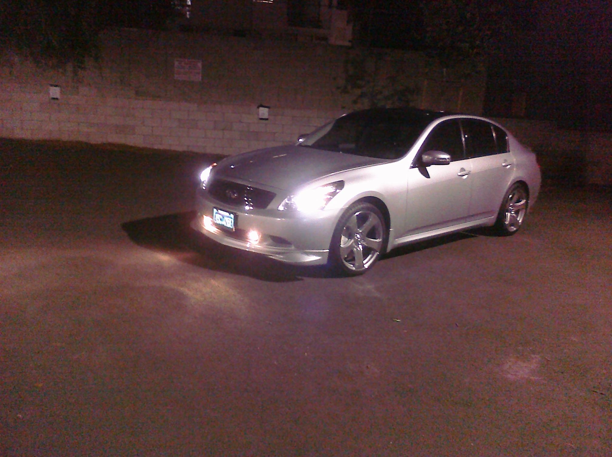

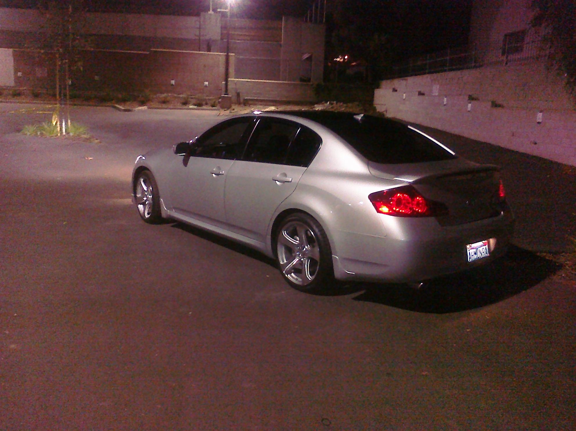

Crappy Pre pics at night...but you get the idea....

Hella nice and tastefully moded!

those rims with that lip look SOLID. nice whip bro. GL with the interview and future ones brother.

can u please post some details of how you installed the fog lights and where did you get it, i really want it on my car. thanks
Old Nov 18, 2010 | 04:50 PM
ParkStr8's Avatar
Joined: Mar 2008
Posts: 349
AudiR8...sorry for the delay.
I got the fogs from JDM i think...it was a year or so ago. Just had them installed.
Basically...they put the car up on a lift. Dropped the plastic sheathing under the front of the car. Then PRECISELY cut a hole in the lower grill (there is no room on the 07/08's on the outer side due to the washer tank on the passenger side - hence me mounting them on the outer part of the center lower grill.) They then created a mounting bracket from MDF and metal and screwed it into the frame.
The wiring just dropped down from the existing fogs...I wanted to use the interior stalk switch...so the electrical part was a breeze.
Does that help?
I did put silbverstar bulbs in the new fogs last week...which are almost obnoxiously bright.
