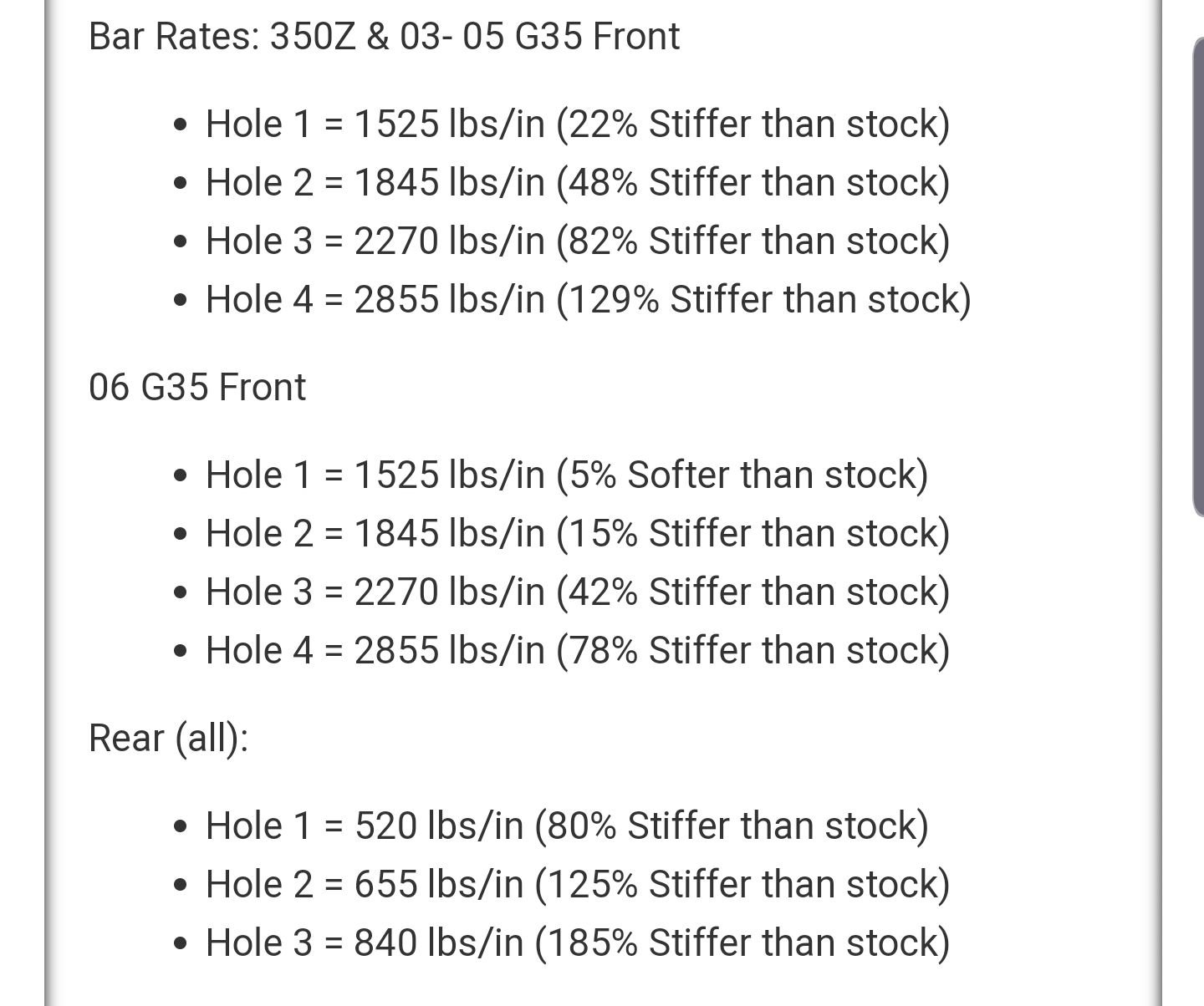

Hotchkis recommends full stiff front, full soft rear as the initial setting. Then you adjust from there.
It's basically the safest setting to avoid oversteer as you learn how the bars behave.
My coupe has full stiff front, middle setting rear for daily driving. I felt this kept my car the flattest (most balanced) on back road drives. I've only done a few track days and aggressive mountain road carving. For those special events I found full soft rear and second notch from stiff on the front gave me the most traction. Stiffer rear setting kept lifting my inner rear tire and triggering traction control system.
Cool thing about adjustable stuff is you can tweak to your driving style/needs. Sway bars were definitely the most noticeable suspension upgrade and I'd even recommend them on stock cars.
I'd start on the softest setting initially and then decide if you want it any stiffer. They're stiffer than the stock bars by quite a bit.
The soft settings are actually softer than stock. At least they were with 06+ coupes (due to beefier stock front bar). Their website list the percentage +/- from stock.

It's not all coupes, just the ones with sport package, aka came with 19" wheels.
I stand corrected, only one setting is softer than stock.

Thanks for reply! That all sounds good, but does that go for the 08 Xs as well? Certainly I can just as I go but I'd rather get it as close to a good fit as possible on the first go.

Fantastic. Thanks @cleric670@gmail !! I called Hotchkis. Apparently for the X, there is no ability to adjust the front sway bar. It only has one hole. One the rear, they recommend the softest setting to begin with. It is listed in their instructions as well.
