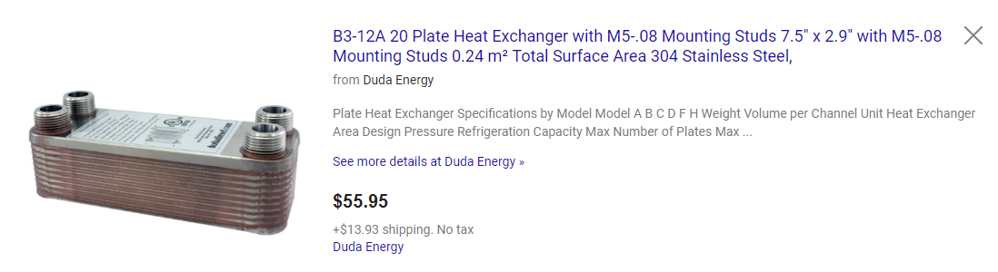

Might get something like this and piggyback it on the coolant line that goes through the oil cooler. I'm planning on adding an external oil cooler as well. I could add a small solenoid valve to shut off the coolant flow once everything is up to temp.

I have personally only seen one radiator / trans loop open up and share fluids and that was over 20 years ago. I have heard of it happening quite a bit but not sure if it's manufacturer defect or other things that cause the problem IE: shock, physical damage, lines bent.... I do know when it happens it will share fluids both ways and you will be able to open you radiator cap and tell right away. I'm not too worried about it on my 08' since I check all the fluids weekly and would probably catch it before it ate the TCU up. You could split the risk and only use the radiator loop during winter months Your idea of a heat exchanger could work well as long as it's built better than what is in the car.

I'd be good with that, could probably use some 3 way diverter valves to choose where to send the fluid.
I don't doubt it's at least equal to the car, my only concern is dissimilar metals and coolant all mixing together.
