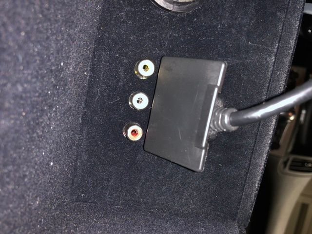

Believe this is the Premium Package system.
With old iPod and Aux inputs in the center console.
I haven’t done anything. I have what I think was the “Premium Package” which doesn’t include Nav, but has a small display screen with Aux inputs as shown in the pics.
You’re correct, camera is my top priority.
Looks like it should work then. Im not sure if theres a way to make your screen automatically switch to video mode when u shift into reverse though. There might be a workaround??
But here is the camera itself:
https://www.amazon.com/TOPTIERPRO-Upgraded-Multi-Function-Reversing-TTP-C12B/dp/B018800TR2/ref=mp_s_a_1_3?keywords=toptierpro+backup+camera&qid=1579449870&sr=8-3 https://www.amazon.com/TOPTIERPRO-Upgraded-Multi-Function-Reversing-TTP-C12B/dp/B018800TR2/ref=mp_s_a_1_3?keywords=toptierpro+backup+camera&qid=1579449870&sr=8-3
