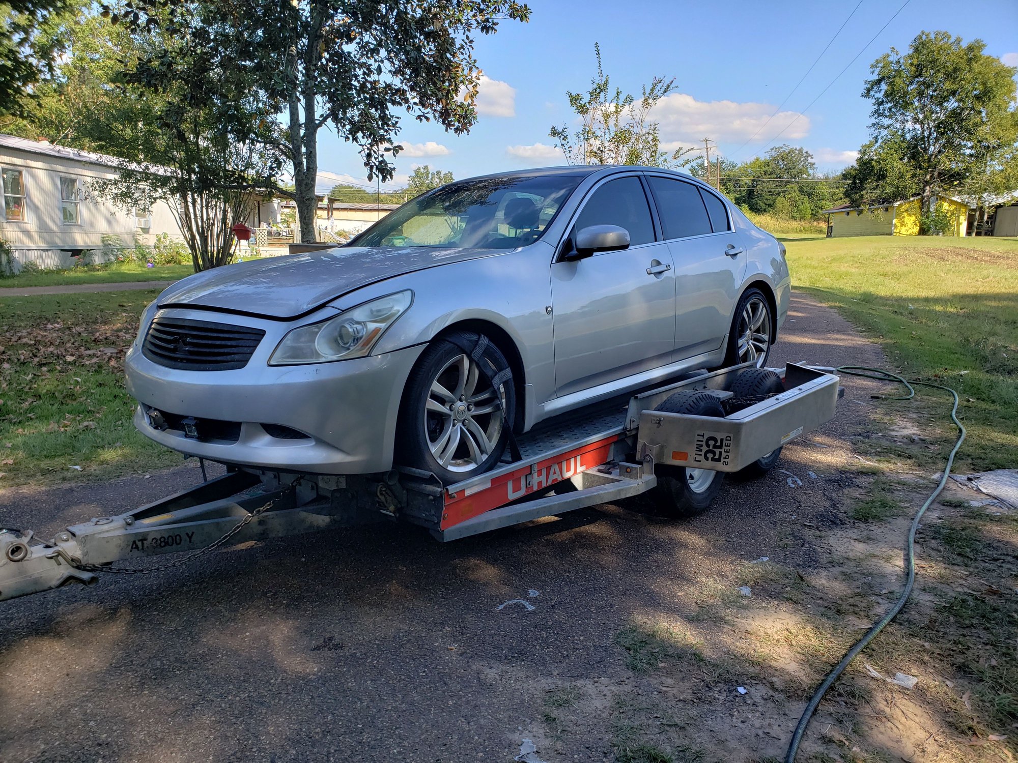

I recently came across a 07 g35 sport sedan with a seized engine. Previous owner went to a quick oil change place and they didn't tighten the drain plug. He made it about 5 miles before it fell out and he apparently didn't notice the light. I've found plenty of engines but for some reason it seems the AWD engines are significantly cheaper than the 2WD ones. Will the AWD engine fit in a 2WD? I know the oil pans are different, but what else would have to be swapped? Found one with 60k miles with a 3 year parts and labor warranty for 1000 plus shipping that's very tempting

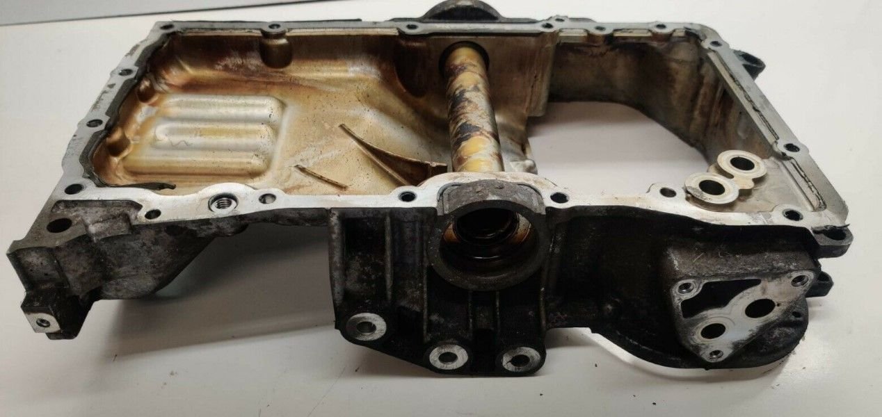

Your mechanic is mistaken, upper and lower oil pan stuff is the only difference (pretty sure oil pump pickup and windage plate are the same but even if they're not you already have a set on your existing motor). He's probably just never taken them apart is all.
Here's a comparison photo of the HR RWD and AWD pans, you can see the shaft going through the middle of the pan in the AWD one for the driveaxle.
