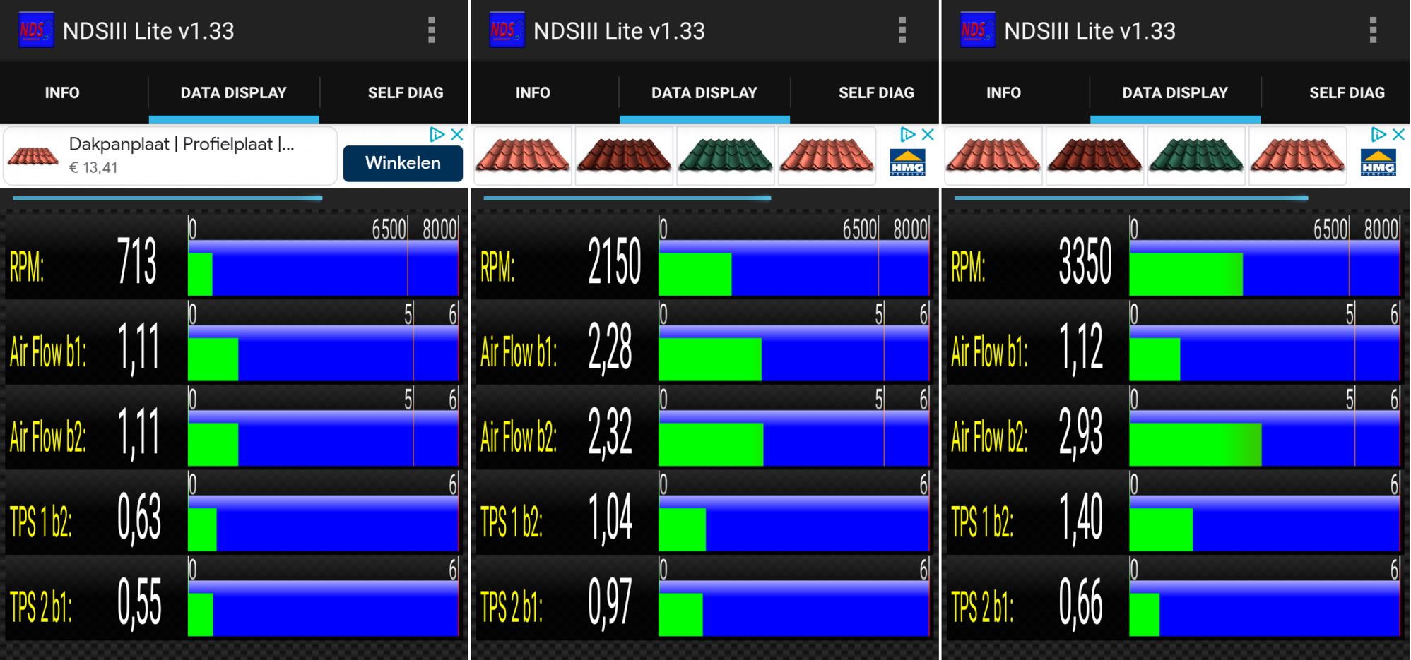

About the MAF, how often do they fail?
I tried to check MAF flow with Nissan datascan 3, most of the time it looks ok.
Right screenshot has some differences, but i think this has something to do with refresh time of the data,
On my previous O2 sensor screenshots the second O2 sensors on the cats were not showing any data, i made a few extra screenshots while driving.

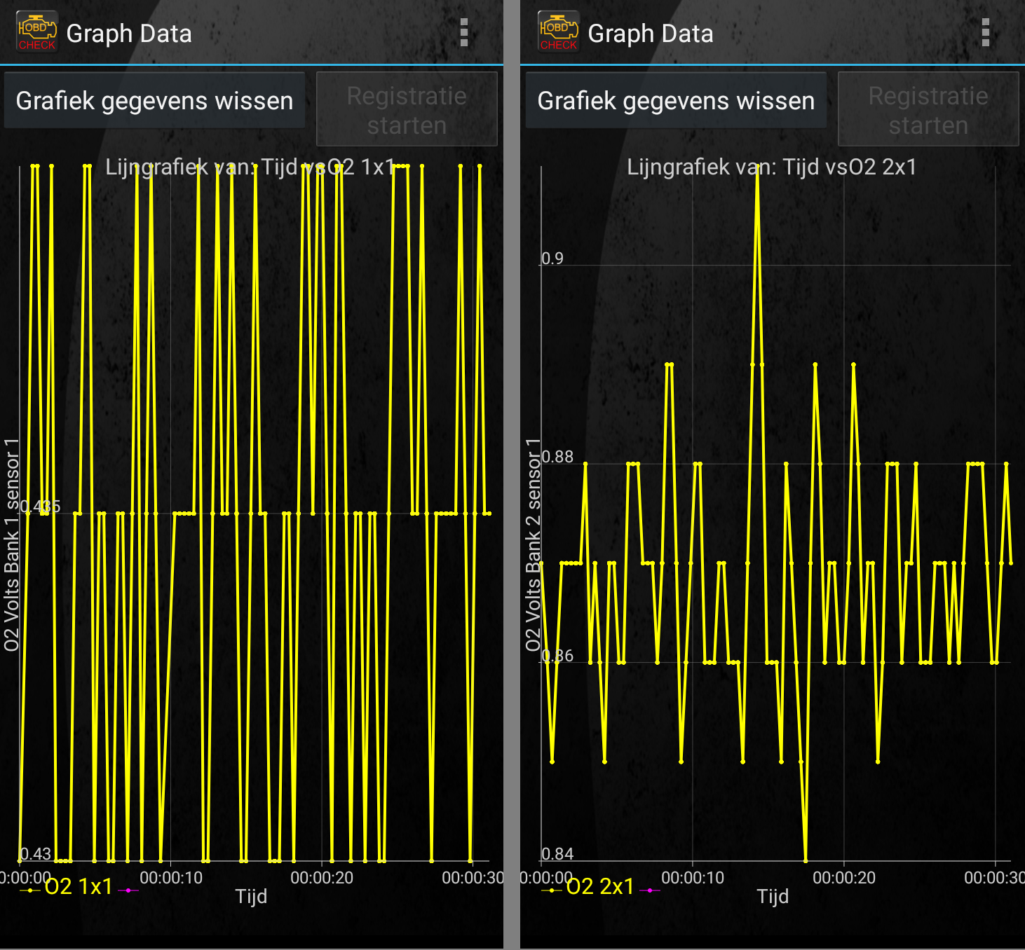

On this screenshots i see the drivers side O2 bouncing a lot, what is normal, bank 1 or bank 2 ?

Your bank 2 is the good/normal one, it should be fluctuating high/low/high/low at idle. If it's not then it's probably not working correctly, judging from those shots you posted it looks like you have a bank1 sensor problem.
Here's a random picture off the internet, see how his bank 1 (red line) has a lot of very spiky peaks/valleys. That's what you want to see, his bank 2 sensor (blue line) is VERY lazy when compared to bank 1.

I just realized I was looking at your bank1/2 sensor 2 data.
Only monitor the bank1 sensor 1 and bank 2 sensor 1 data.

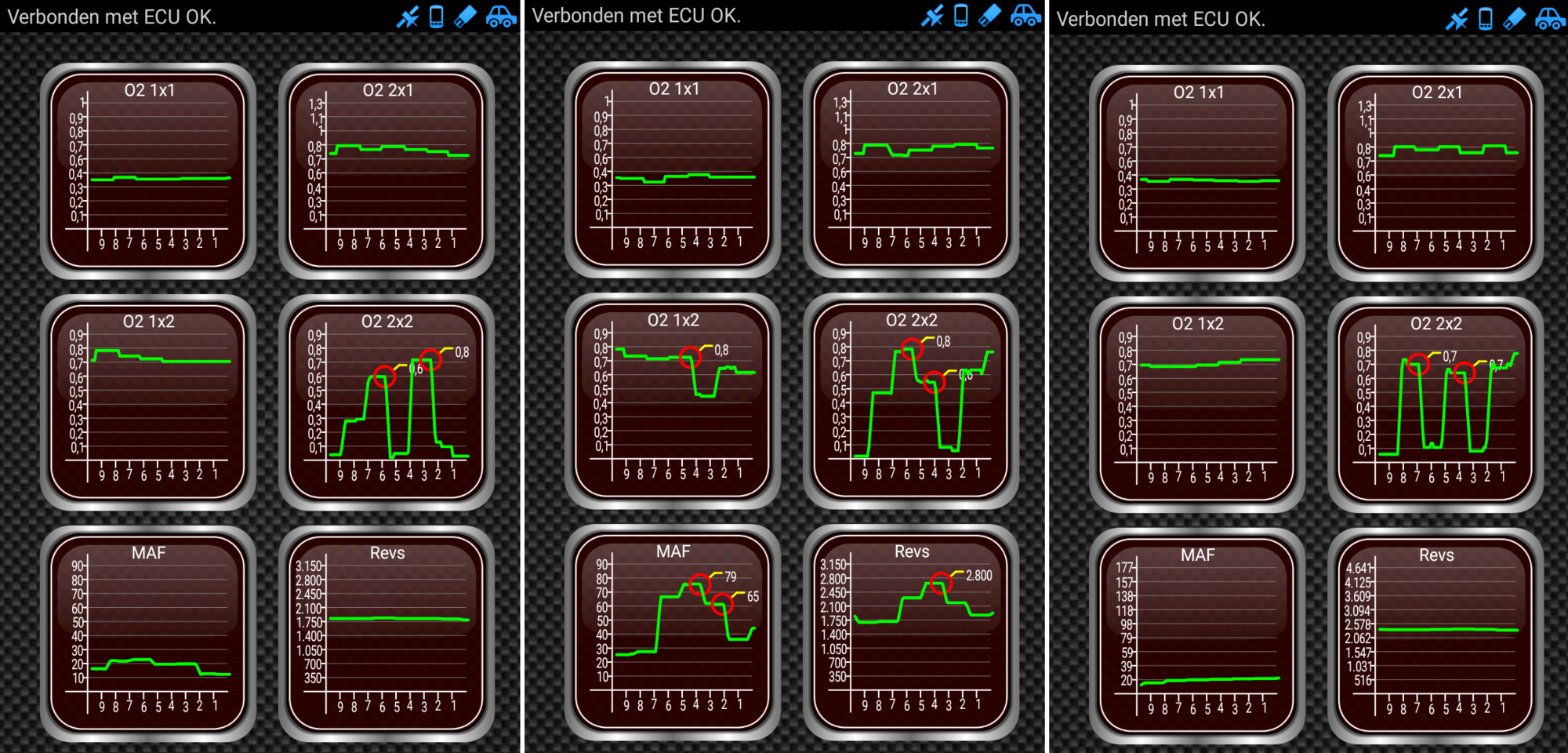

Ignore all the sensor 2 stuff, that's just catalytic efficiency and not your air/fuel sensors which are the sensor 1 data.
The resolution on those little graphs is terrible though, if you have an android phone and an ELM32 Bluetooth OBD2 adapter you should try out the app Torque Pro it's gives MUCH better sensor resolution.

Feb 20, 2022 | 01:27 PM
The previous displays are made with torque free, these are made with torque pro
I tried to get both sensors in 1 screen, but the app wont let me do that.
All data is made at idle, like you told me, hope it shows something for you.

Feb 20, 2022 | 02:57 PM
Clear the codes, try to narrow down EXACTLY what makes it trigger. I suspect it's only going to throw the code on a cold engine. Keep your BT adapter and stuff in the car so you can clear it when it pops up if it does it cold, then see if the code comes back when the engine is already up to temp.
When the O2 sensor heaters are on the verge of failing you can get codes like this and that's what I'm starting to suspect.

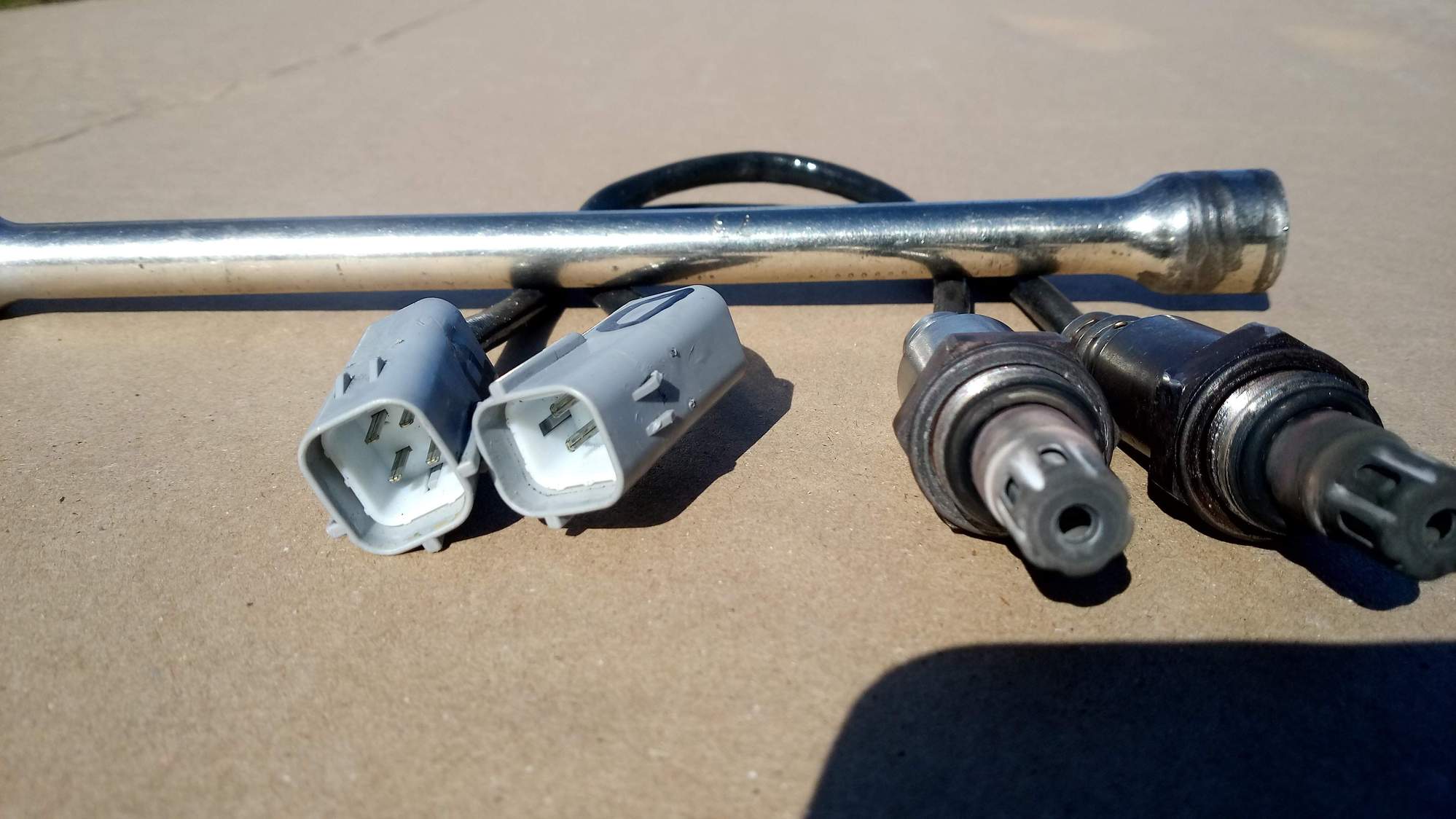

I ordered a Yato O2 removal tool, it arrived yesterday
Today i switched out the sensors between bank 1 and 2.
It was not as hard as i expected it to be, with the right tools i think it can be done in 1 hour.
After reinstalling the O2 sensors i expected bank 1 to be richter now, and bank 2 should be more lean.
Strange thing, this did not happened, O2 values are still the same, bank 1 a little lean, bank 2 a little rich.
So the sensors seem to be ok, but i will check the sensor values again tomorrow, just to be sure.

I took some pictures, just for fun.
Both O2 sensors are OEM (Denso) 211200-7020
I tried to clean the text on the left one, but after that most of the text was gone.
