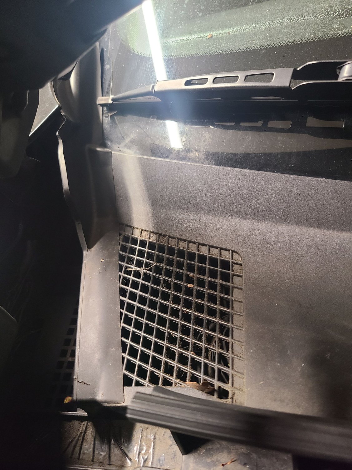

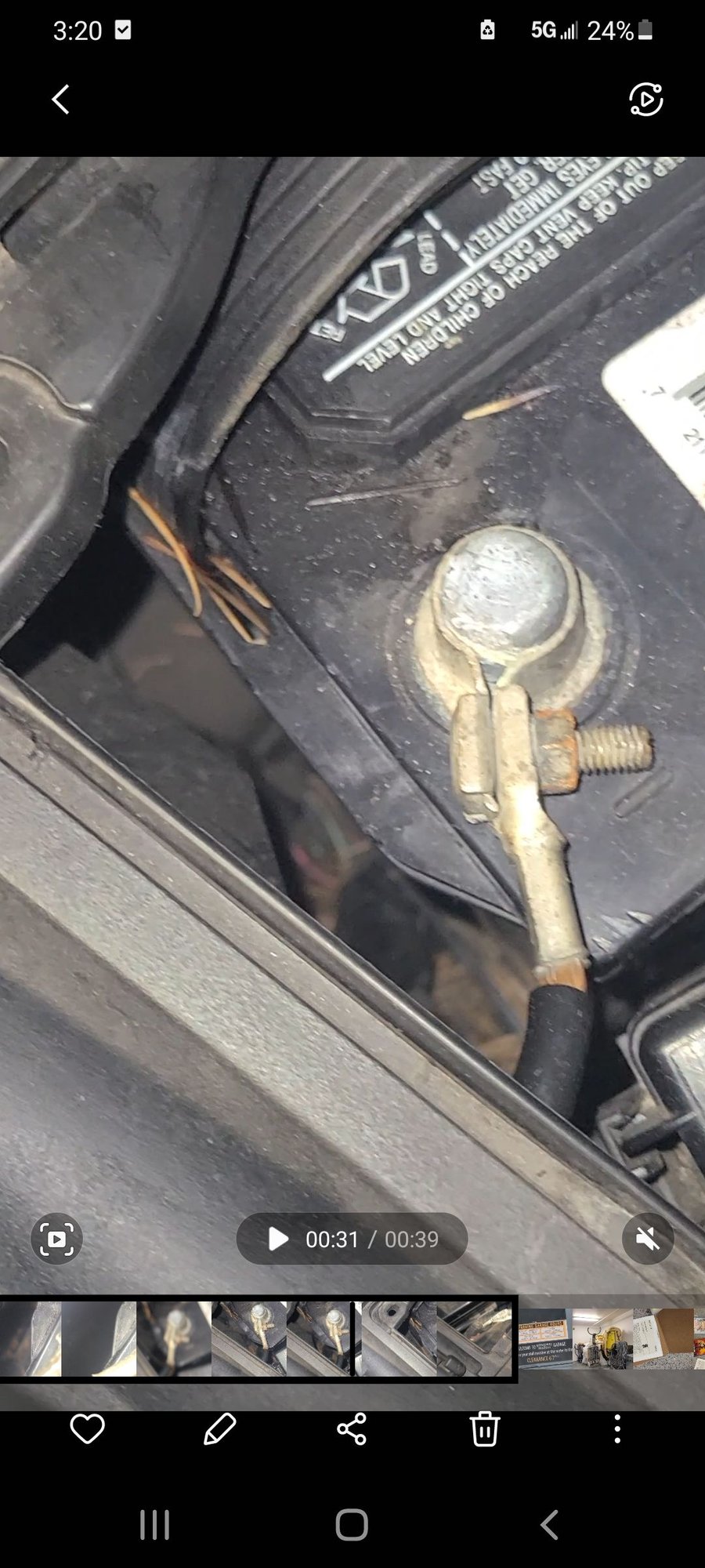

When it rains heavy, Ive noticed that there is water pooling underneath the battery, It never caused any issued since the first time I noticed it a few years ago. Recently though when it rained it seems to have messed the circuits causing the VDC light and some others to randomly come on. Checked the breaks and they are like new, this problem only occurs in the rain. I took a picture when it was dry but you can see some pine needles down there. The draining system seems strangely designed to poor water around a circuit board and some wires that aren't totally covered in electrical tape. Any thoughts on what I should do? One mechanic that looked so far was clueless. Thanks a million!

This same issue has happened to about a million other people. Its the IPDM that gets wet and goes haywire.

Mostly it's just making sure to clean the 15 years of debris out of the factory drains.

There is a drain under that battery tray that is clogged

Battery tray itself shouldn't ever be filling with water, that only happens if the cowl drains get clogged and it pours off the front of the cowl cover.

There probably was water inside your ipdm.
