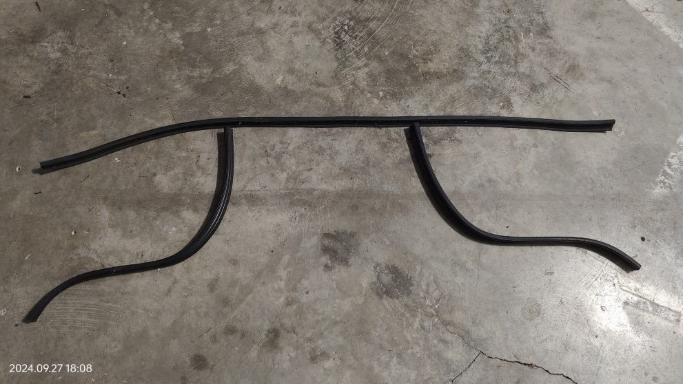

I've been lucky so far since the water pump replacement but i did remove the 3 rubber mouldings/strips to vent out heat from under the hood.. Here in south florida, it gets HOT so instead of cutting holes in the hood, i removed the rubber pieces and temps never go past 200.
Old Sep 26, 2024 | 03:33 PM
99zx2turd's Avatar
Joined: Apr 2016
Posts: 299
Likes: 47
which ones are those? got a pic?
Old Sep 27, 2024 | 04:09 PM
G2B35AGN's Avatar
Joined: Mar 2013
Posts: 1,994
Likes: 390
From: Raleigh, NC
I think he's referring to the ones up by the cowl that then wrap the battery and master cylinder "compartments."
Old Sep 27, 2024 | 06:19 PM
MaLPoPieS's Avatar
Joined: Jan 2024
Posts: 381
Likes: 128
From: Princeton, FL
Jaguar XFR-S
You can see the light coming out, i've shut the hood and let my flashlight on top on intake manifold. If your PCV system is sealed and you have GOOD valve cover gaskets, then you won't have any oil burning smell coming inside your cab. The windshield might fog up when AC is on, blasting on Defrost after the rain. I never use Defrost anyway.
