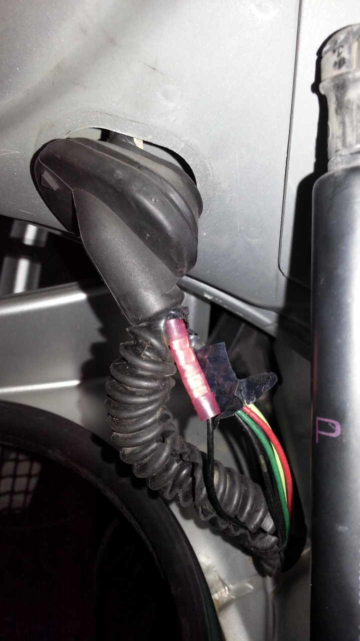

Not to beat a dead horse... As shown in the pic you can get an idea about where the wire was cut. Also, as you can see I personally used butt connectors. I discovered (as a few G members have as well) the "black (ground) wire" was severed as opposed to others who have had the 'green wire' cut instead. ***Note- check all other wires within that harness!! Upon further inspection another black-white wire was on its way out and damaged (not severed but wiring was exposed), so I decided to cut it through and through adding a second butt connector to it... Forgot to mention that I crimped the ends of the butt connector two times each side, four total crimps (as opposed to crimping only 1 time as most people do when using these kinds of connectors) so as make sure the wire was completely secured. ((Soldering is ok but in my experience it takes too much time to heat the gun, heat the wire and mess with the solder itself trying to get a good seal while its scorching hot, plus you almost need to have 3 hands to do this!! Not only that but over time the solder can be prone to breaking and cracking because it may get brittle)) Butt connectors also add some length to the wires you're repairing, they're very solid and besides it's extremely simple- so no worries here... Afterwards, I tightly wound electrical tape to both repaired wires for overall added protection from movement, moisture, the elements, etc...

You can either solder the wires back together or use butt connectors.. I did the latter bc it was easier for me, IMO... Also in my case it was the black wire (ground) that was damaged not red and/or green ones, not all wires are created equally so it'll be different for everyone (stating the obvious).. As you see in my picture this was right after I reconnected the wire using my aforementioned repair method above but right before I wrapped it back up with 3M electrical tape for extra protection. Hope this helps.... This is my repost from post # 107...
Update from post #111: from 100,033 miles to currently at 114,557 miles my fix using crimp connectors (aka butt connectors) has been working flawlessly so far. After a little over a year and almost 15,000 miles, I've had no problems whatsoever via using either the trunk dash switch and/or my keyfob trunk remote button........

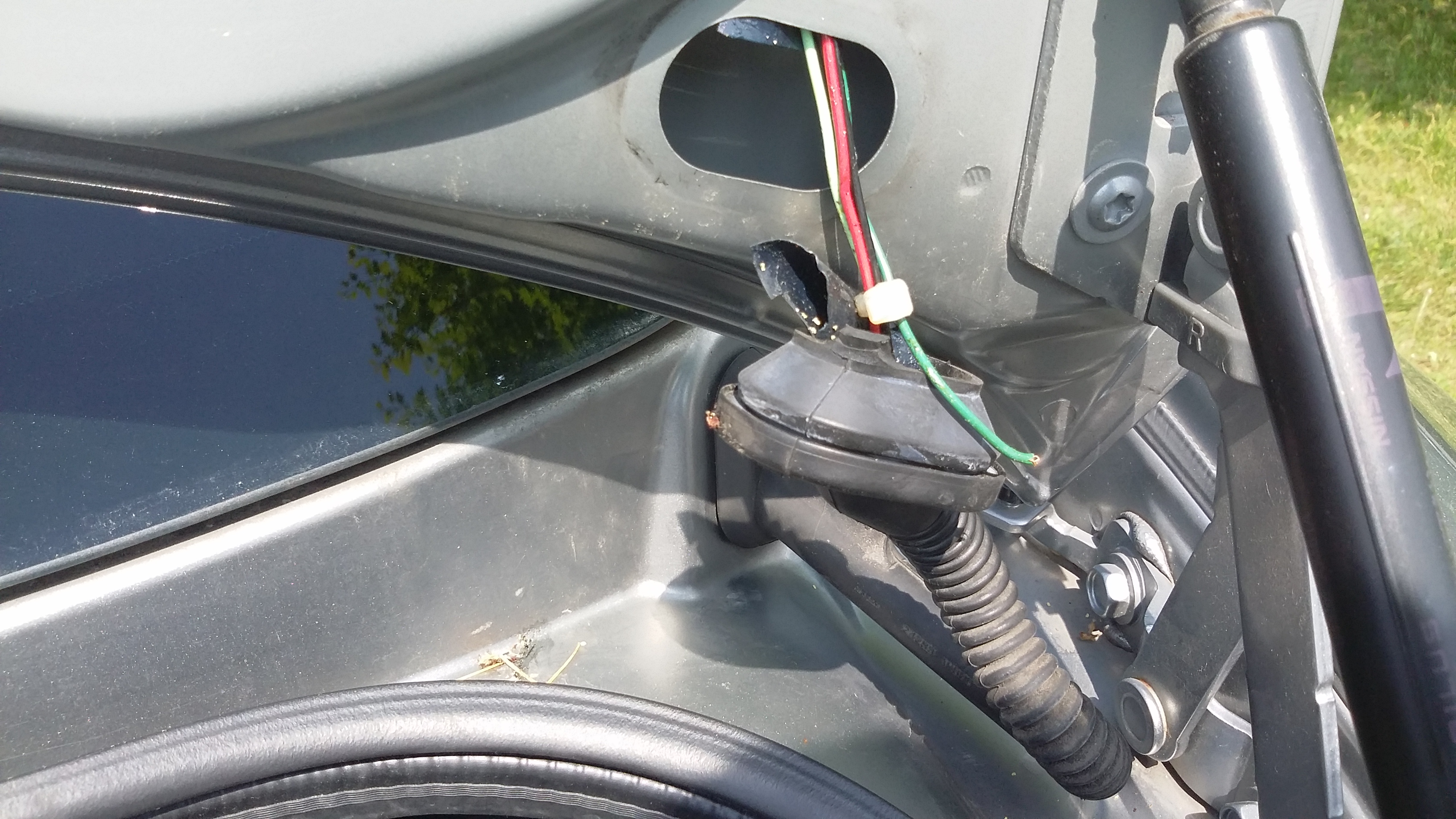

The trunk was not working.
1 fuse near the clutch were ok
2 fuse near the batterie were ok
3 on/off switch in the glove box was on
Last thing was to look for dead wire and it was the case. The green wire was cut and one of the black wire was almost gone. Did some soldering and voila
