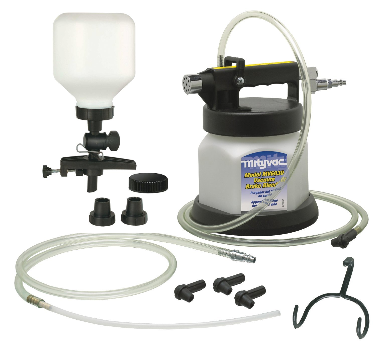

I had a lot of trouble getting mine bled too, ended up using a MityVac vacuum bleeder attached to my compressor, and it worked perfectly. Had it done in about 10 minutes from park to bled.
