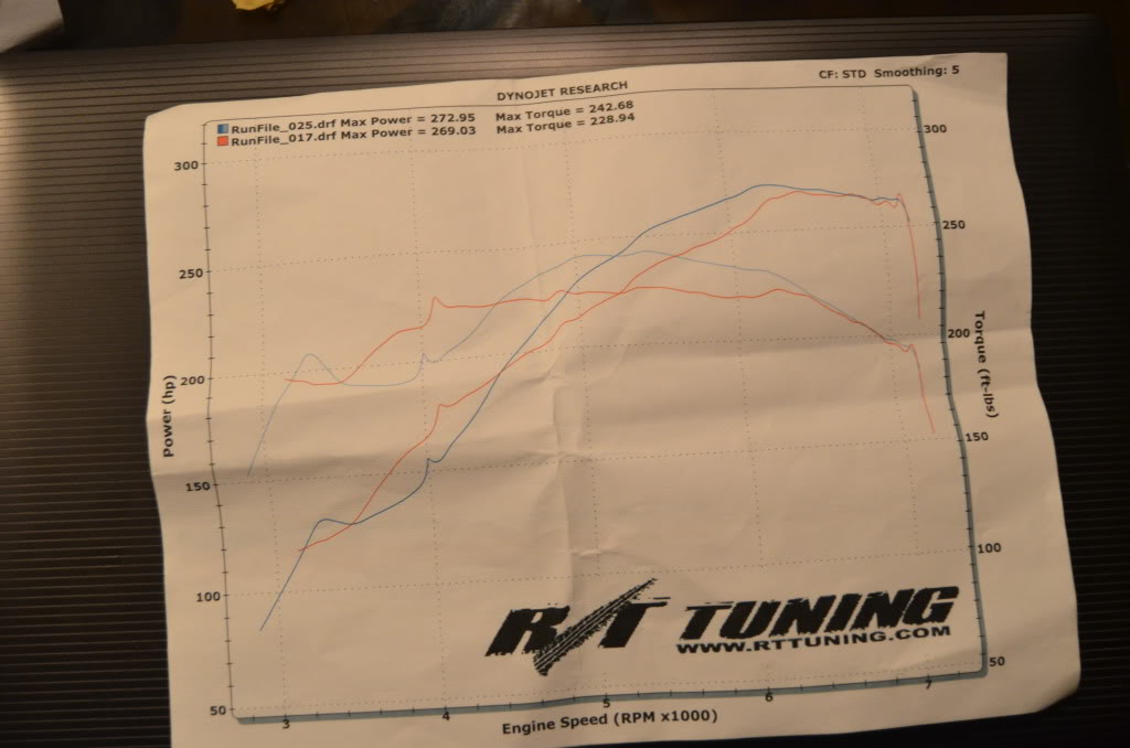

no that will be tomorrow at RT. The runs tomorrow will be compared to run 25 which was right after the headers were installed.
Here is my same day dyno of the headers.

Dip is still there, but not as drastic. I plan on going to the track soon and see if my 60ft change back to normal.
I have the topend just my launches are slower now because of the drop.
Before the headers I would run 13.8@101 with a 1.9-2.0 60ft with headers 13.8@104 with a 2.2-2.3 60ft.
PPE is looking into my issue.

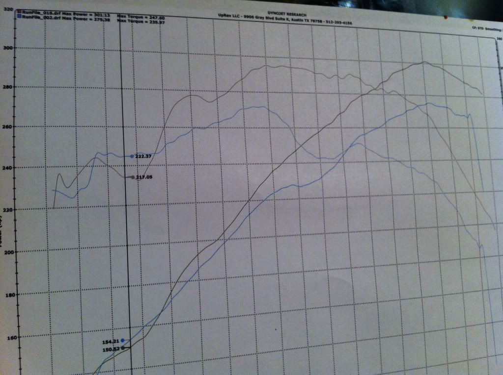

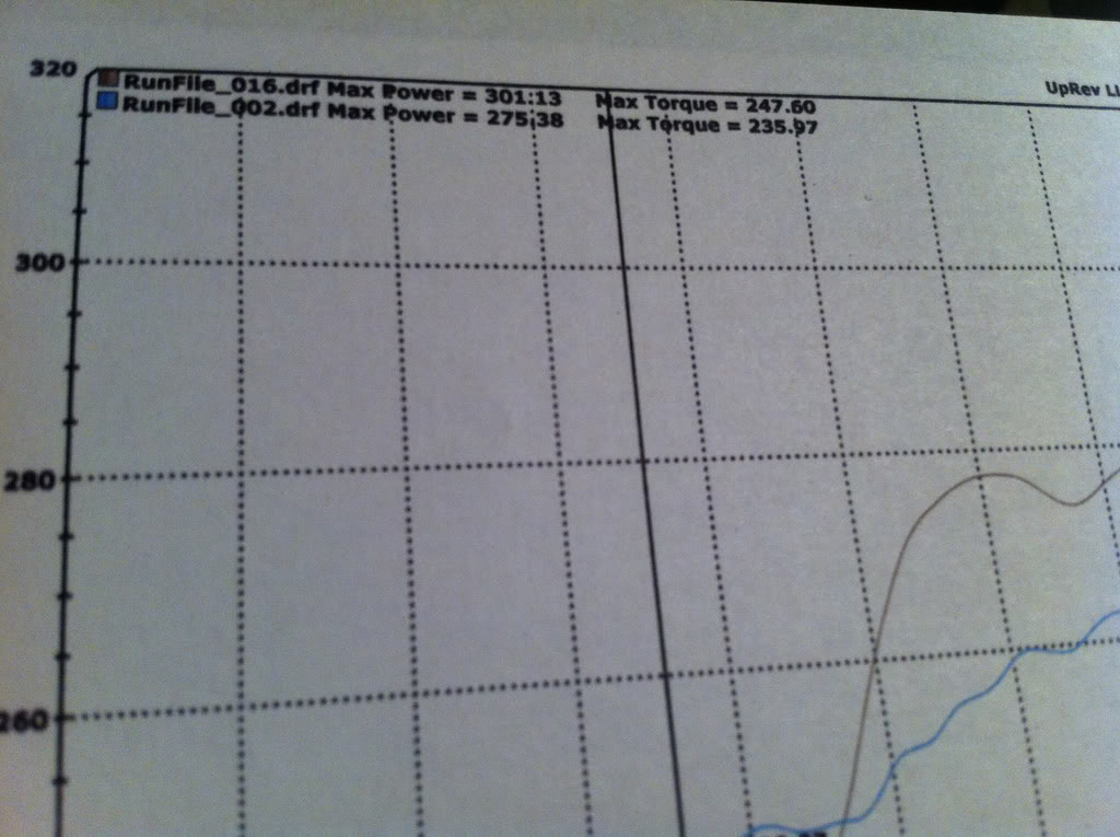

here is what the 350zHR put down.
Mods intakes and longtubes only
He was not tuned when he pulled 275 he only had intakes. The 301 run is after the LTHs and a tune@uprev.
The HR headers are identical to mine. I'll take that little loss down low my losses in that range are 214tq (b4) -194tq, 157hp (b4) - 142hp = - 20TQ/-15HP between 3200 and 4200.
