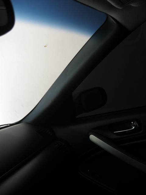

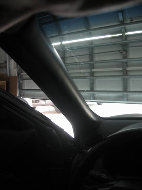

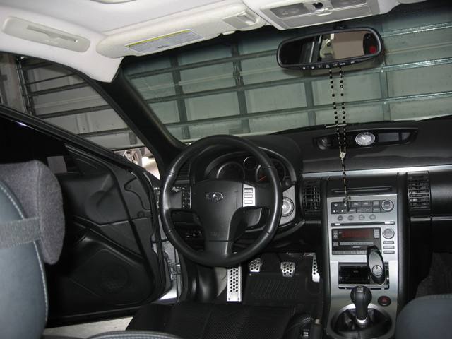

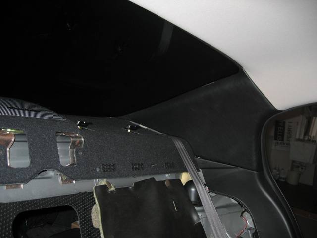

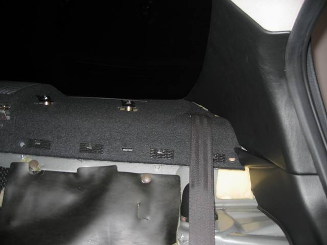

well i started to trey and pop the headliner off but only ended up making it dirty! =/ wasnt really taking my time so i will attempt it with a friend this time...heres how the rest of the onterior pillars are coming along:

Wow... that looks really good.. Are you wrapping with real leather?
I bought a few cans of high quality fabric dye and I plan on dying my headliner/pillars etc. I also bought some classic car plastic dye to dye the dome lights etc.
What are you using to keep it glued?
How did you get the pillars in the front off.. I've been trying to pry those all morning and I'm afraid of breaking them!@#

....to glue i am using the strongest 3m spray glue adhesive possible (i think 88) u can get it at bennet auto supply, etc...
