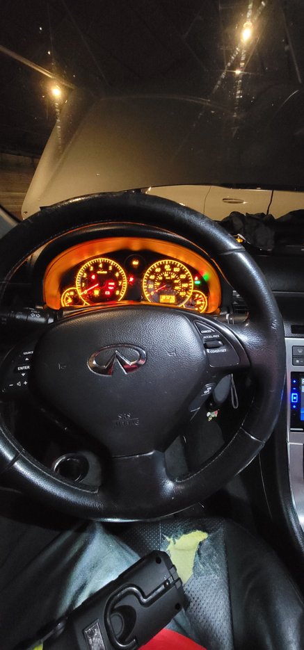

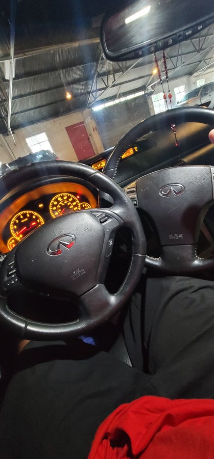

Talking G37 steering wheel in a 05 g35
So thanks to the group I did the swap and like everyone else my buttons was all over the place but I was too lazy to remap the buttons. When i finally changed the radio the horn quit working so I had no choice but to repin the wheel. Lucky for me i kept my stick wheel and just copied the colors of the pins. I literally used a safety pin to unlock the pins after i took off the harness lock. Like stated before my green wire for the horn ground was solid yellow on the g37 steering wheel but all other colors matched. The horn is now in the correct place and my cruise control work. The volume button and all the other ones doesn't work BUT again i have aftermarket radio so im not sure if it controls the stock radio fully. I couldn't find anymore information on this swap so i just tried it and it work. Especially with steering wheels being cheaper now vs 10 years ago. Ill keep everyone posted with a gtr steering wheel im trying next.
