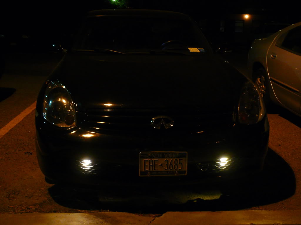

Yes I have. I have a sweet pair of PIAA 998 turbojector projectors. Here are a few pics, they are BRIGHT as hell!! By the way, I swapped bulbs out for an H3 HID kit lol

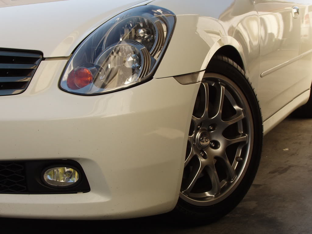

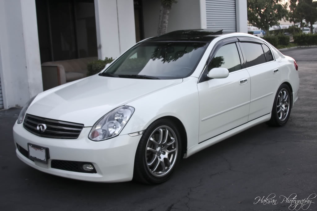

Anyways, you have to custom fabricate it yourself.
I have a diy thread here somewhere or 6mt.net
Mine.

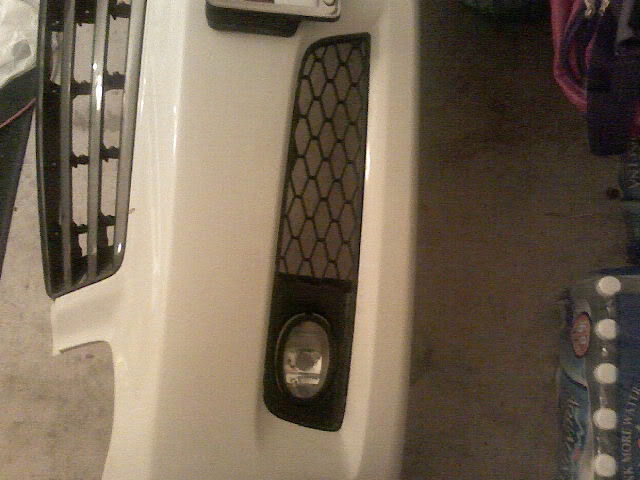

i put fogs in, but i hid them behind the grill.

they are suprisingly bright, but the way i mounted them they dont quite point high enough, they basically cover between the front of the car to below the regular headlight beam.
i will admit, these are kinda cheap lights i bought at autozone, there little baby projectors, but they arent too bad. gonna go hid, just deciding on a color.
if you have any questions on doing it behind let me know. Took about 3 hours to install

did you pull the whole bumper or just removed the inserts...
Old Nov 20, 2008 | 10:48 PM
gizmo134's Avatar
Joined: Apr 2008
Posts: 443
From: LB NY, Currently Socorro, NM. HELP ME!!!
^ pulled the inserts. got some self tapping screws, went into the bumper support. ran the wire up, and put a relay in the brake fluid area thingy.

nice, kinda gives me something to do, i have a set of OEM lexus ES300 fogs projectors, you just ran a normal relay and toggle switch with +/- independently?
Old Nov 20, 2008 | 11:09 PM
gizmo134's Avatar
Joined: Apr 2008
Posts: 443

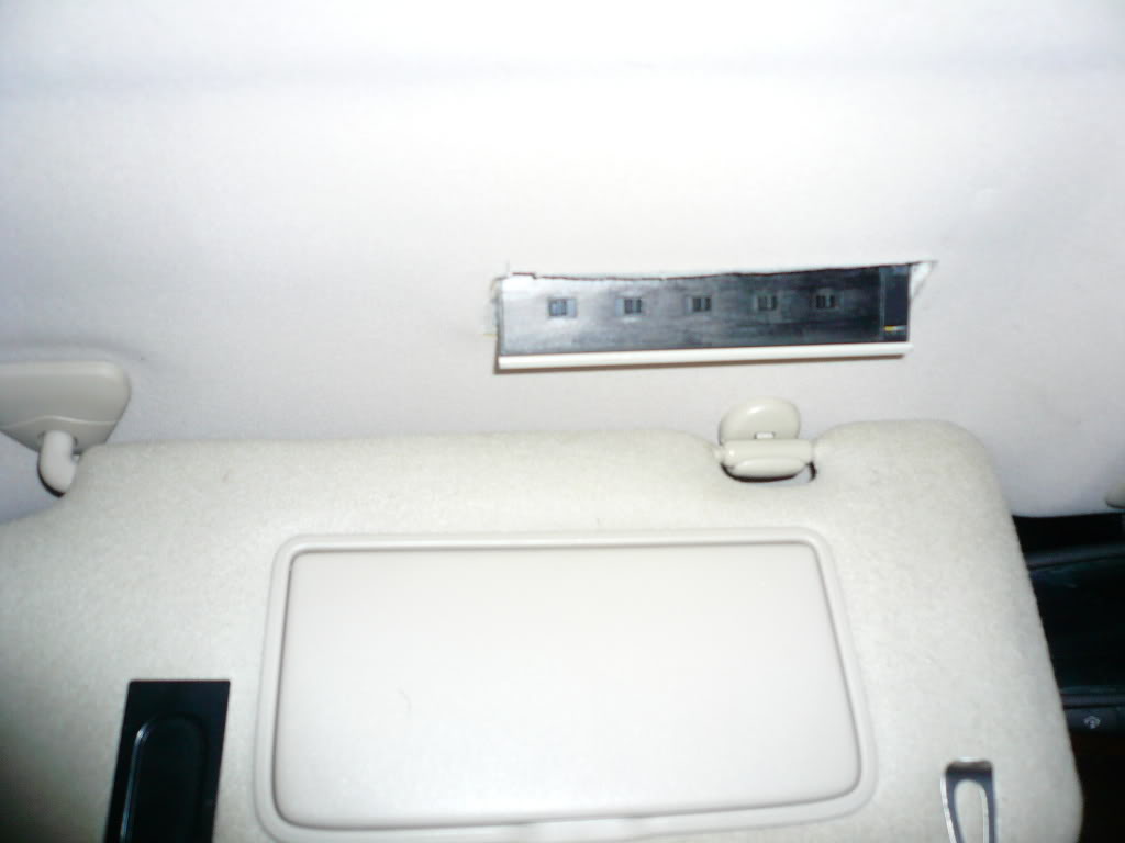

i grounded each light at the fixture, and ran a pos. to the brake thing. mounted a relay in there, ran a fused line accross directly from the battery, then a wire into the car.
you could just toggle that, but i actually have 2 switches, one to turn them on and off, and another to have them go on and off with the ignition. "daytime running lights" haha
for switches, i wanted to be alil different. im deciding what to use to finish around this, but this is what i have.
when not being used, it flips up into the celing
