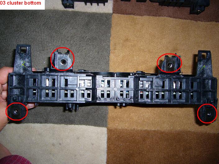

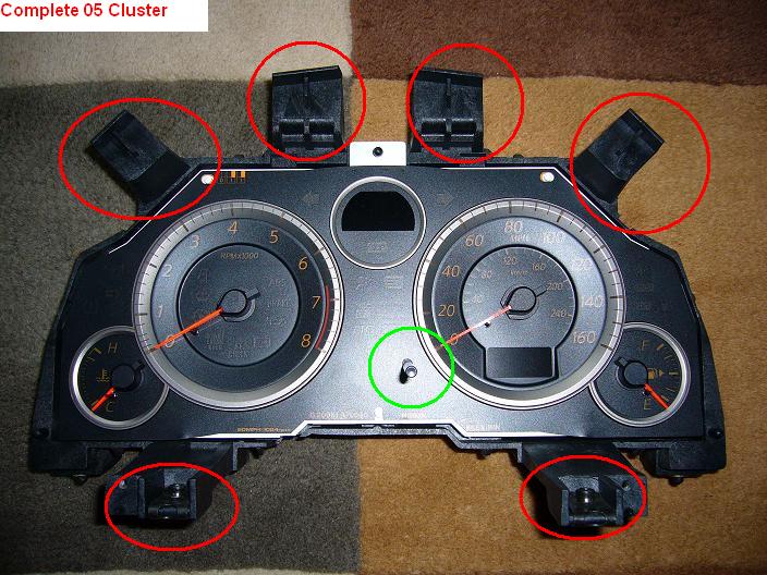

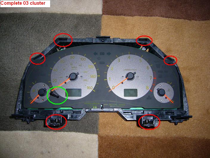

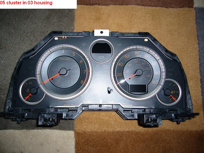

Still have not been able to find a set of 05 connectors. I did get another 03 gauge cluster from ebay so I could remove the male connectors for my inline adapter.
There are also a few more complications when looking at the two clusters. The first is that the two housings are physically different. I'm referring to the black plastic housing that the gauge cluster sits in. The 03 housing is thicker than the 05 housing. The 05 housing has additional supports at the top of the cluster and 2 of the 4 mounting holes on the bottom are in different locations.
The good thing is that the 05 cluster will fit into the 03 housing with a little help. The 05 cluster would need standoffs to make up for the added space in the 03 housing.
Also, if you look at the 03 and 05 gauges, the "plunger" or push button that controls the trip computer is on the left side of the 03 cluster, and on the right side of the 05 cluster. This would mean you would have to either a) drill a new hole in your clear plastic housing and figure out what to do with the remaining hole or b) find a new clear plastic housing with the correct hole location and hope that it fits the 03 shroud.
Pic are attached for reference.
Just purchased a new clear plastic cover from an 06 gauge cluster. This way I will not need to drill a hole in my existing clear plastic cover for the trip computer plunger.
I'm getting a little impatient in my quest for 05 connectors. If I don't find any 05 connectors I will just solder directly to the 05 cluster that I have. Once I finish my double din install I'll look into doing this.
