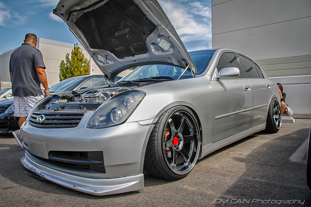

Trying to run them all the way around or just in the back? I can tell you we are running a 10.5 +22 245/35 in the rear. Car is running 4.1º of camber to make them fit. You will need even more camber and possibly a smaller tire.
Here is the car
19x9.5 +12 (after 10mm Spacer) 225/35 2.7º & 19x10.5 +22 245/35 4.1º

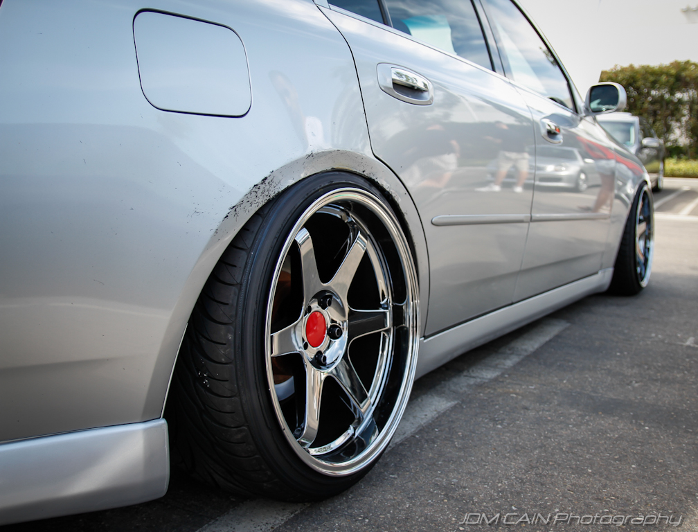

+12 out back, -6 camber and a 235/35 tire. Fenders were cut (would have been better to pull them). Fronts are 9.5 -3.

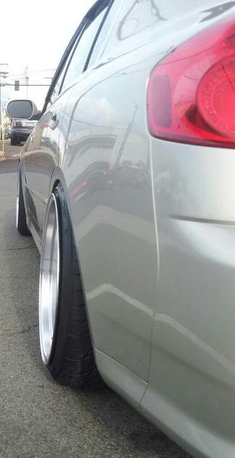

im running the 19x11 +25 setup right now at 3.7 degrees and the tires are barely touching fender just rolled and no pull. kinda amzed it fits and im a bit lower then the g Marcus posted
sorry crappy pic
