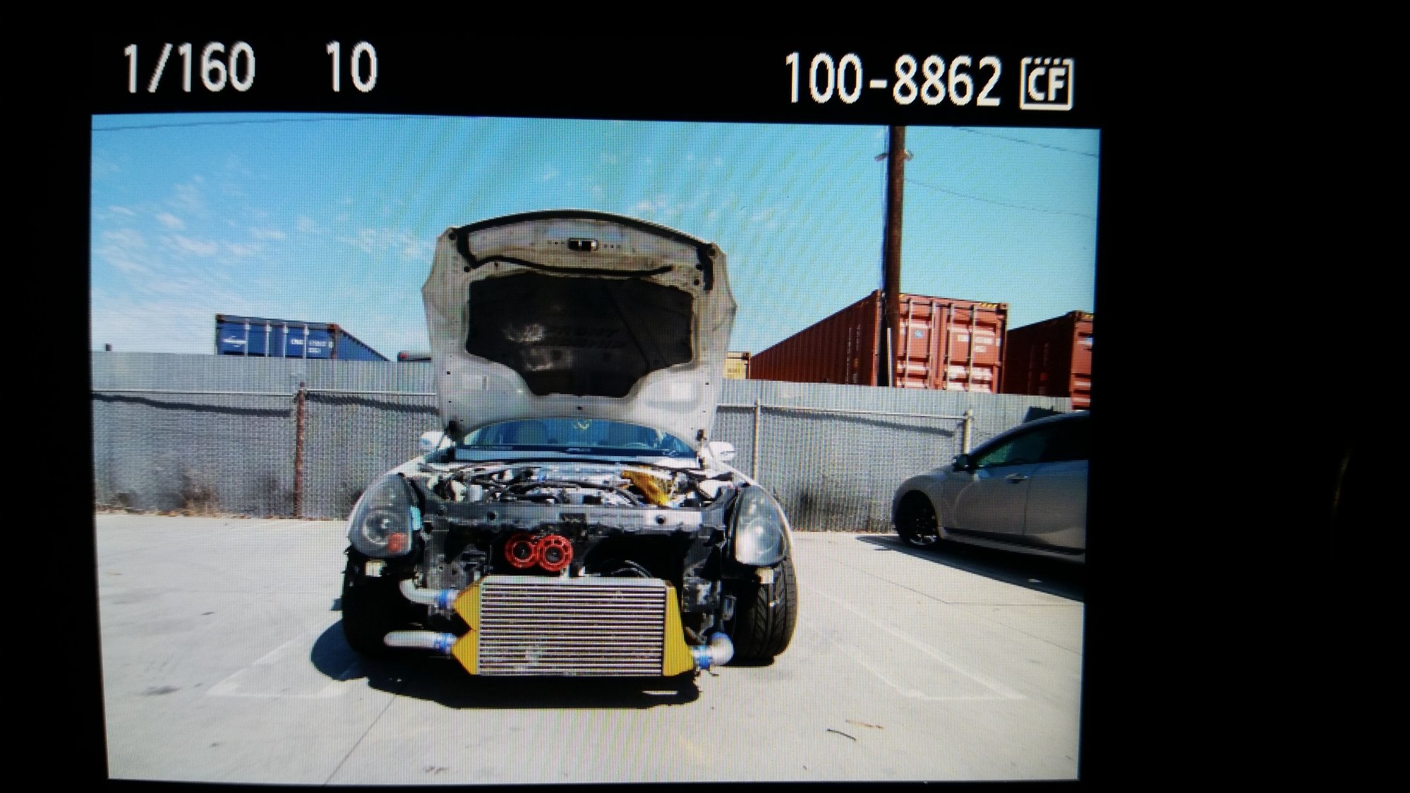

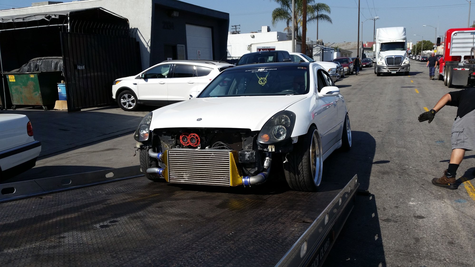

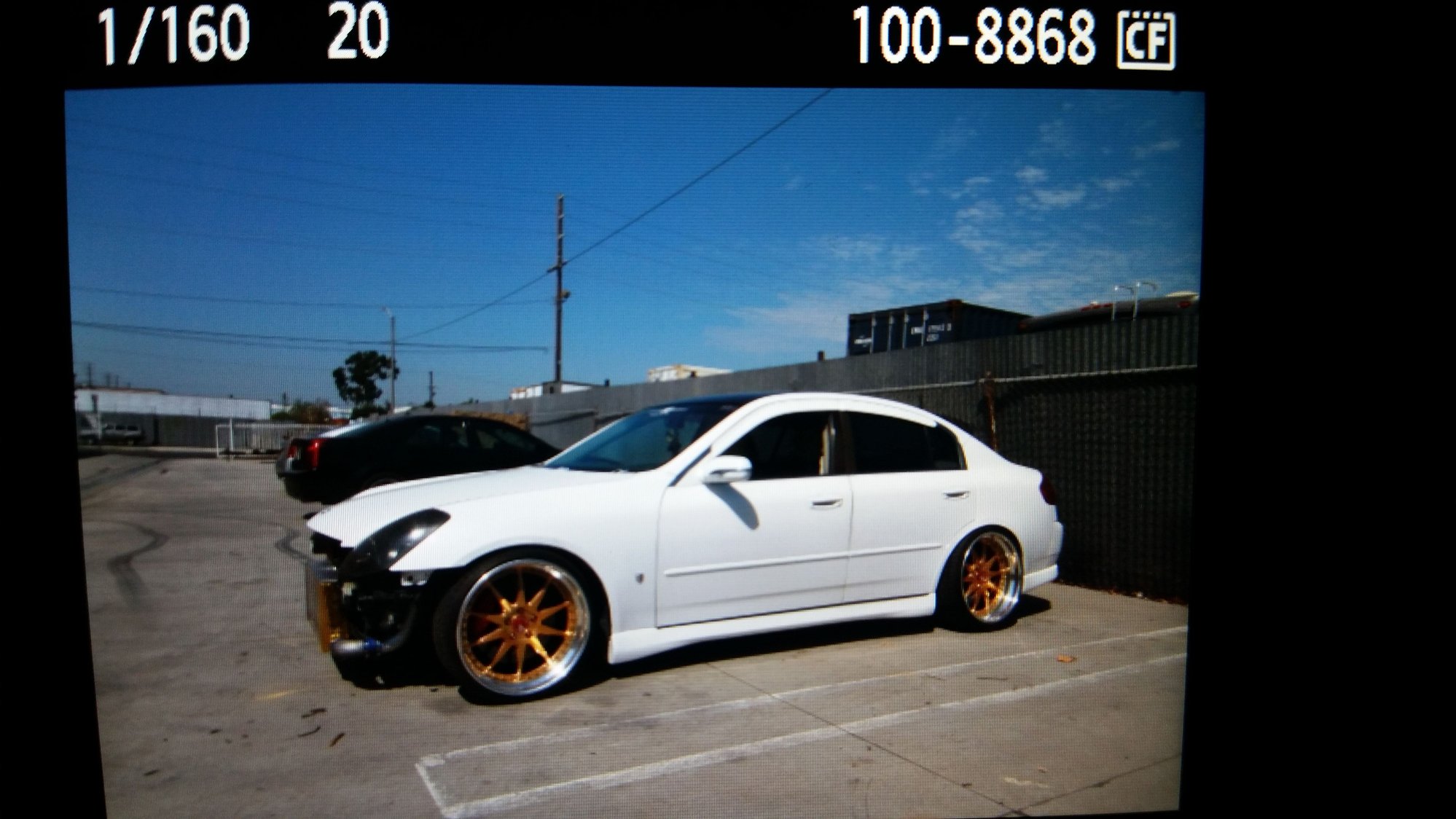

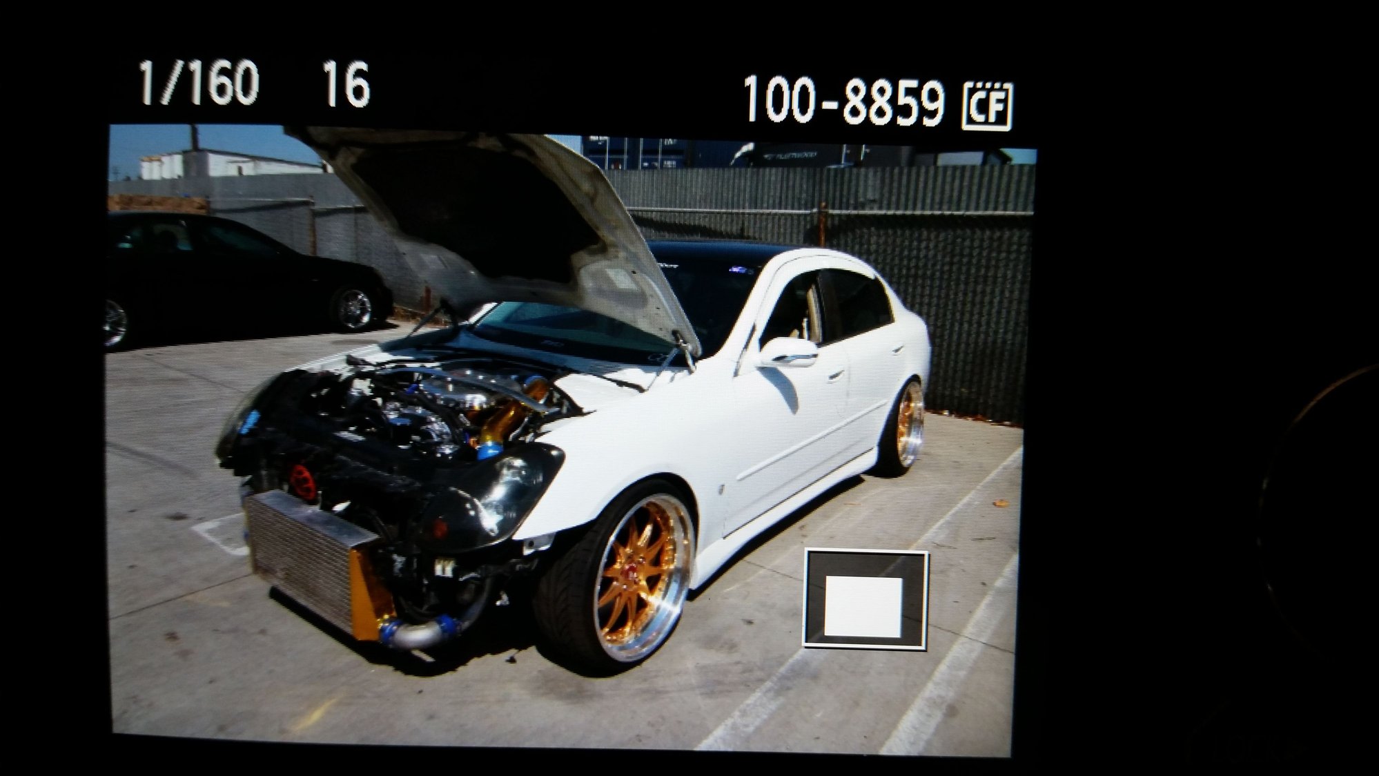

Here's more pics from today before tune:
Loading up to get towed to tuner.
#Turbostance
#Turbostance

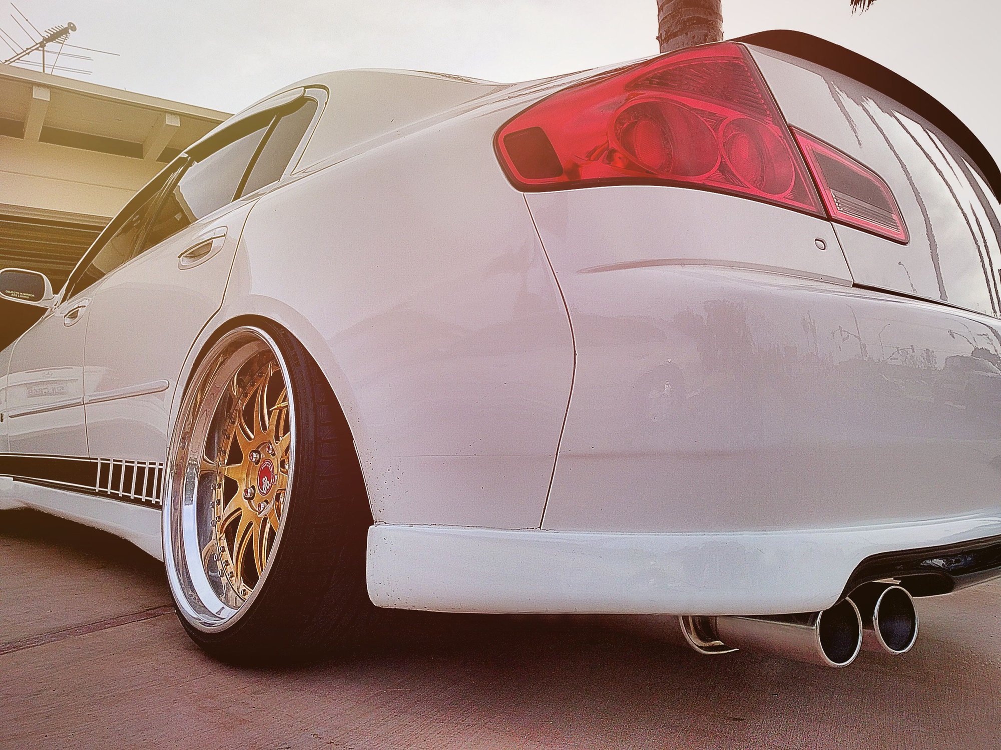

Been a while since I've updated...here are more recent pics:

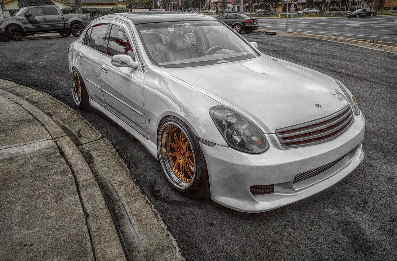

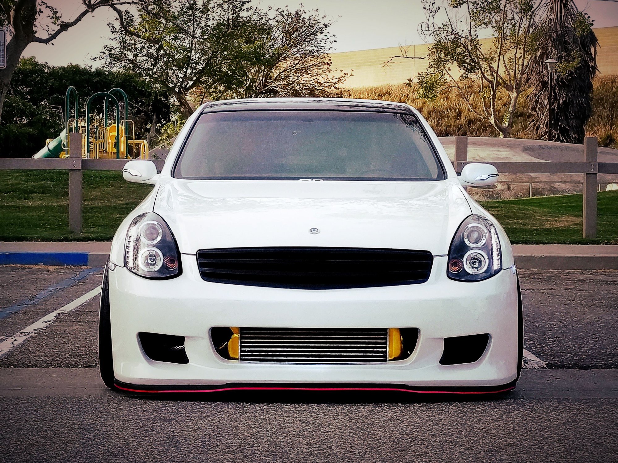

Say hello to my new friend. It's foam car washes, polishes, and ceramic coatings from here.
Installed a new vinyl graphic for a different look.
New headlights installed before shrouds and sequential LED mods to install.

How difficult was it to wrap your intake tubing. Looking beautiful by the way.
that looks like DEI heat reflective gold tape on his cold side turbo charge pipe. its not difficult to do, and yes i think it looks good too. plus it keeps the air from the intercooler from being reheated by underhood temps before entering the engine.
nice job.
i like the GS300/Aristo in your pics from last yr too.
Thanks Mr. Brooks
Yea..installing DEI gold heat barrier tape wasn't hard to install. Just start at about 20-30 degrees angle, and it should wrap well. I bought it from Summit Racing. I used 2" tape, but if I were to do it again, I'd go with 1.5":
http://www.summitracing.com/parts/dei-010395/overview/
nice job.
Thanks EPiK!
I know the wrap around the intercooler is more aesthetic, but I also wrapped pipes that ran close to the manifold. I'll probably do lower plenum too since the plenum likes to bask in heat.
