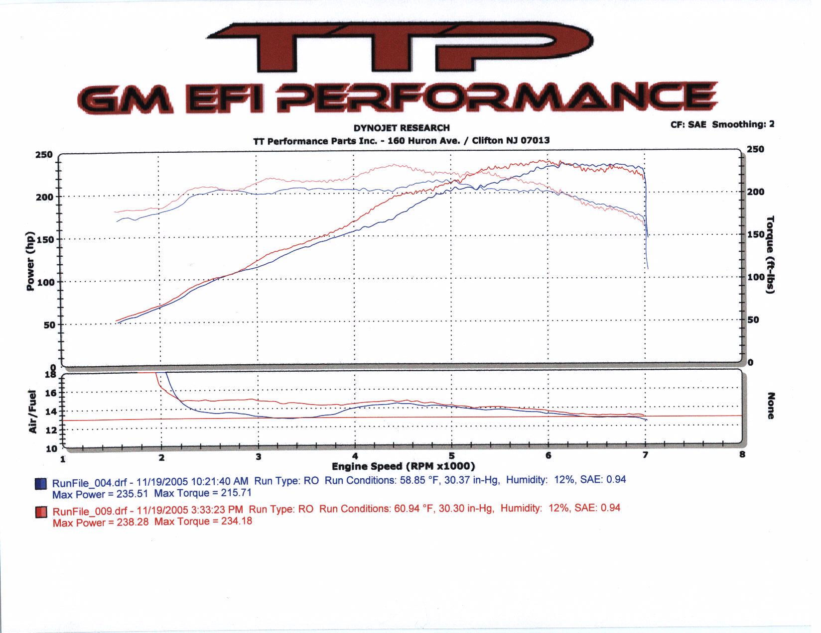

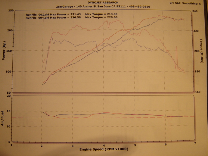

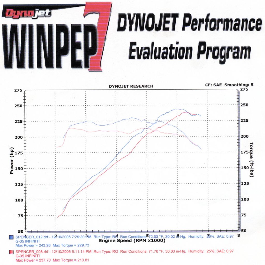

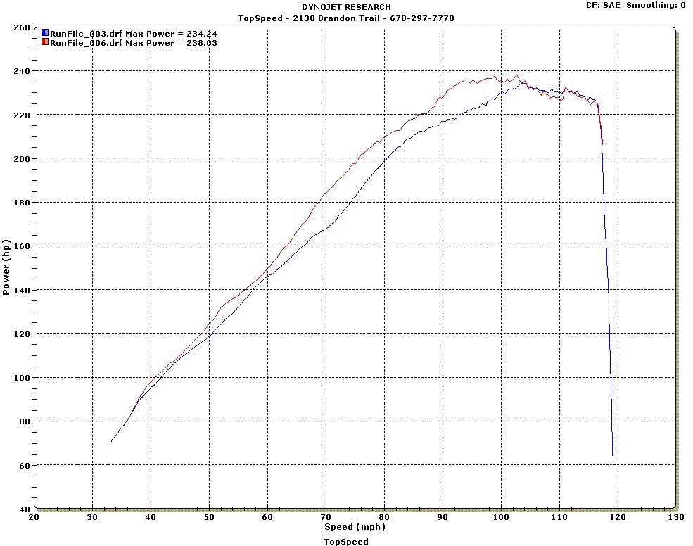

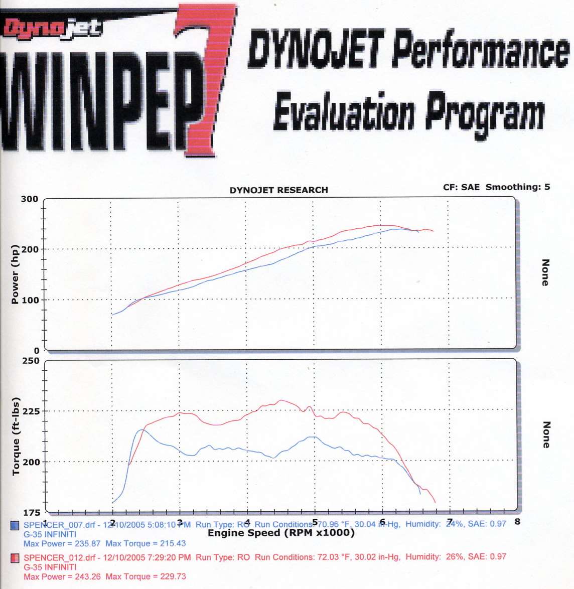

Attached Thumbnails Motordyne MREV Mod-azsi2k-dyno-plot.jpg   Motordyne MREV Mod-cloud-.jpg   Motordyne MREV Mod-diesel350-mrev-.gif   Motordyne MREV Mod-spencers-mrev-dyno.jpg   Motordyne MREV Mod-spencers-mrev-dyno-2.jpg

I assume those are all dynos of stock versus MREV with 5/16" spacer? Do you have any comparisons of MREV with 5/16" spacer versus just 5/16" spacer on '05+ cars? I'm curious what the high-end / mid-range torque trade-off is with the '03-'04 lower collector.
If you add just the 5/16 spacer on a MREV car it has shown loss of power.
The above is before and after dynos of the MREV package.
The 03-04 collector gains the low end TQ back. But it takes away from the high end.
Now the 5/16 spacer gives some more of that high end back. So in all the car gains.
Almost. They are stock Vs MREV+.
MREV+ is a modified lower collector with a 5/16" spacer. MREV and MREV+ only work on the "REVUP" engine.
The machining process to the lower colletor reduces or eliminates the loss of power typically seen above 6200 RPM. The machining process doesn't change the peak HP much, but it does add significant area under the curve.
