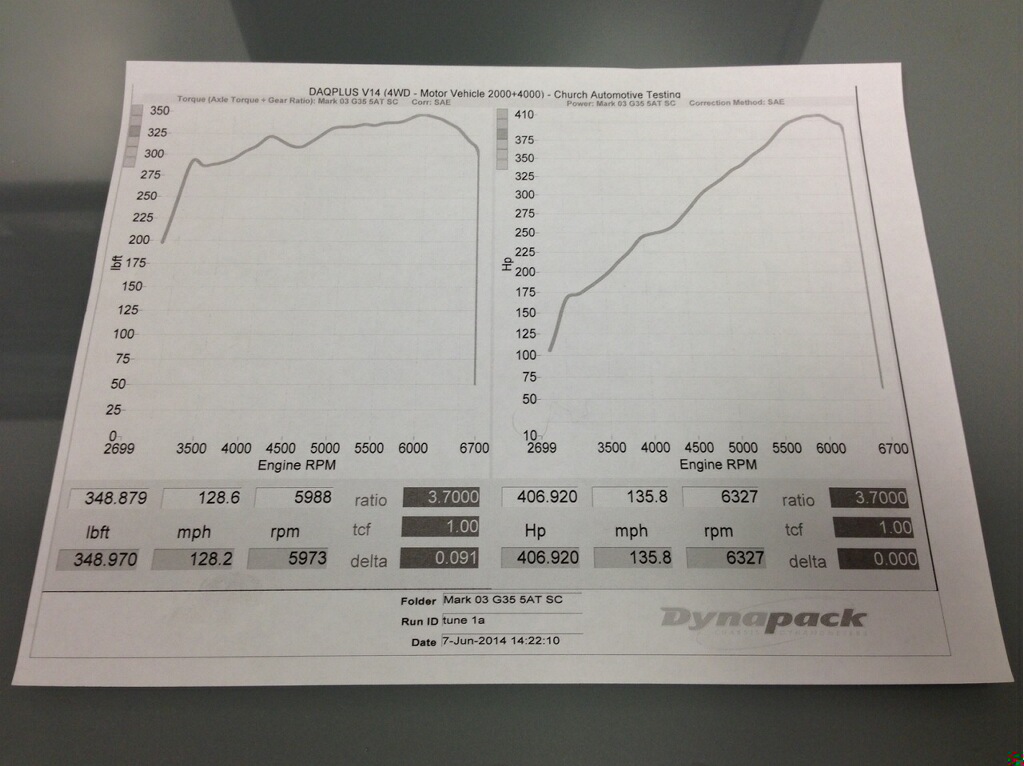

it's official, I was able to successfully get a tune with the Halech w/VoltageDrop harness

No before and after dyno because got the tune with Vortech v3 kit

SD, how is the system working??
Old Oct 13, 2014 | 02:04 AM
  #300
SDGenius's Avatar
Joined: Jan 2008
Posts: 12,810
Likes: 911
From: Oside, SoCal
very well, as far as I know. i haven't gotten my car back and driven it yet. there were quite a few hurdles we had to overcome due to the many, many variables that come along with adding a modified FI kit to an already modified car. HP & TQ curves look very nice and I'm told the car is running very strong, so I'm inclined to think everything is pretty harmonious at the moment.
