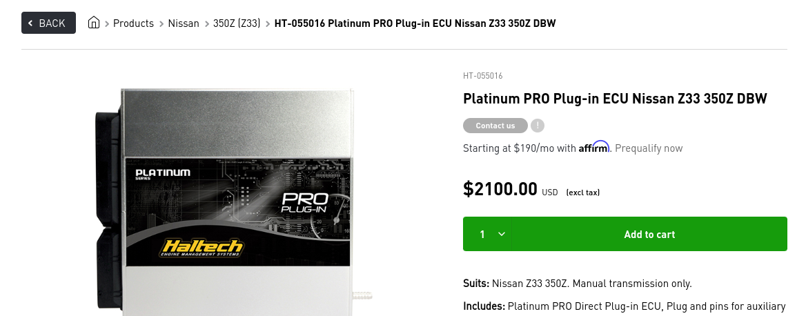

its the premium
Question would this new haltech work on my g35 sedan 6mt?
heres the link do the product:
https://www.haltech.com/product/ht-0...o-plug-in-ecu/

Likes: 2,497
From: Washington State
Coupe 6MT Premium RAS
Yeah but what do you need a standalone for? Unless you need it for boost applications where you need extra safeties like boost cut and whatnot then you're better off with an Uprev tune. Not to mention it's only about 1/4 the cost and you get to keep all your other car stuff intact with no dash lights.

its the premium
yeah I’ll be tuning it myself and I’ll be using twin turbos
Ahh, check out which ECM you have in this thread (it's the one in the middle with the black housing). Make sure it's harness/plug is the same in the Haltech video.
