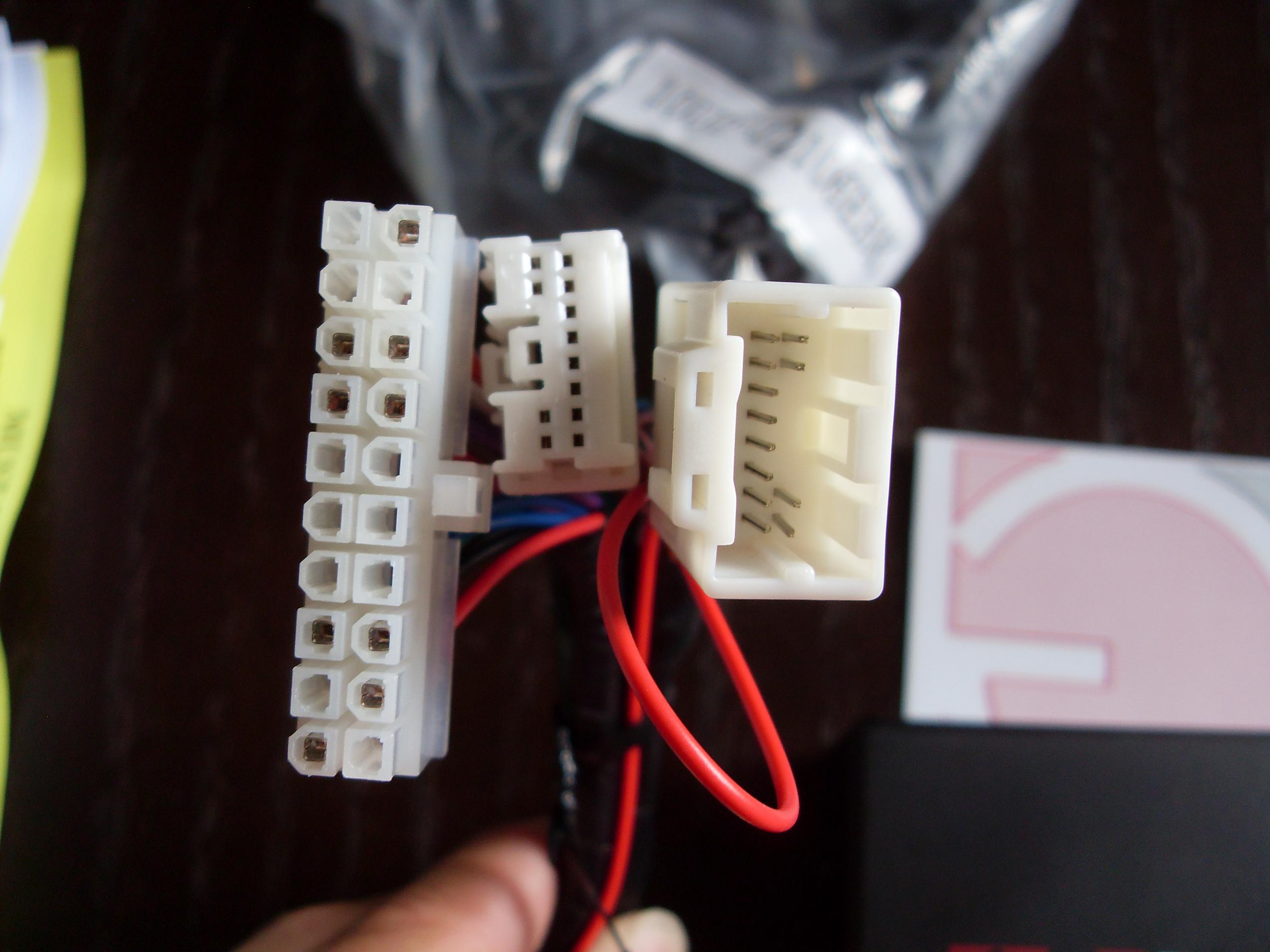

Received the USB module today. Might try installing it tonight, but will probably wait until tomorrow. For now... pictures yay!
Attached Thumbnails Grom Audio USB/IPOD integration Guinea Pig-sdc10615.jpg   Grom Audio USB/IPOD integration Guinea Pig-sdc10618.jpg   Grom Audio USB/IPOD integration Guinea Pig-sdc10620.jpg

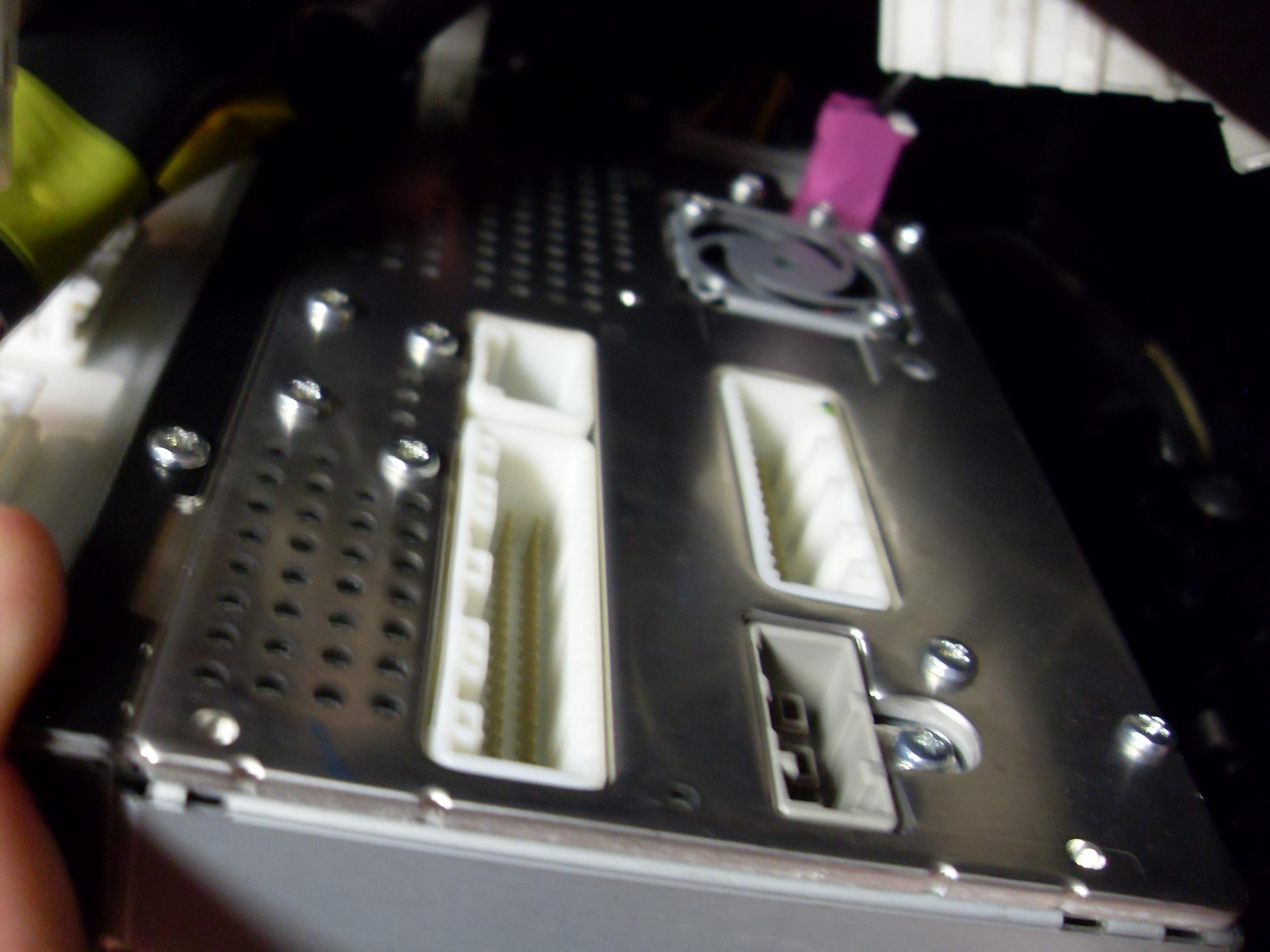

well damn.
The cable supplied with the unit doesn't seem to fit anywhere on the radio....
I have contact support, just waiting to hear back.
Remmy, did you have the same car as me? 07 g35s with nav/music box?
Attached Thumbnails Grom Audio USB/IPOD integration Guinea Pig-sdc10630.jpg   Grom Audio USB/IPOD integration Guinea Pig-sdc10622.jpg

i had the non-nav/non-bose model stereo but i could have *sworn* it fits your car too....you're sure it doesn't fit in that one smaller plug receptacle?

yeah. The pinout appears different. I'll see if I can get a better shot of the rear of the radio after work.
They have an 2009 FX35 w/ Navi install tutorial using the same cable on their website. Everything seems fine there. Maybe I'm missing something, but in pic 2, the middle connector is the one that is supposed to go into the back of the radio. The only connector on the radio that is CLOSE, in the second connector on the top row, but like I said, the pinout is wrong and the connector doesn't fit anyway.

thats very odd. could be they just sent you the wrong cable. alberto at grom is pretty quick to reply, maybe he can shed some light on this.
and i know this is a dumb question because im sure you checked but your stereo does say "CAT" on one of the buttons, right?
***edit****
so i checked the g35 shop manual and that harness is definitely not compatible with your stereo. you may need to ask for a different one OR maybe you will have to hook it up directly at the satellite radio module in the trunk. i would look into that.

The cable looks like the one they show in the pictures. If I can dig up an infiniti wiring diagram, I can figure out which connector they NEED to go to, since they're using the sat interface. I could do my own wiring, but I'd rather use a nice connector if possible.
