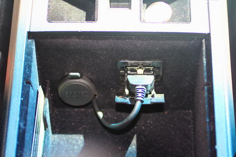

I saw a few posts on here lately that state that all iPhones since iPhone 4 cannot be charged. Just wanted to bust that myth.
I have a 2008 G35 Journey with the non-USB factory iPod port in the center console. I previously owned an iPhone 3GS (old 30-pin connector) and that one charged fine, which is as expected. But I have also owned an iPhone 4S and iPhone 4 (wife) and we were able to get both of them connected fully to our factory stereos (navigate artist/album, now playing, steering wheel controls) AND charge the phone batteries.
I used the iSimple® ReVolt™ (IS710). See my earlier post for specifics: https://g35driver.com/forums/v36-aud...4h2-1ba0b.html. Basically, this cable looks like a long extension cable for a 30-pin Apple charging cable. I plugged it into the end of the factory iPod cable that comes with our cars (Part # 284H2-1BA0B). When I plugged an iPhone 4 or 4S into that, it works.
My wife and I recently both recently upgraded to the iPhone 5S, which has a different charging connector (Lightning). Hell will freeze over before Infiniti actually releases a new cable. But I was able to use the genuine Apple 30-pin to Lightning converter on top of the iSimple ReVolt to preserve all of the same functionality (full connection plus charging). The reason I emphasize the “genuine” Apple cable is that I had about five other, cheaper converters either purchased locally or online and none of them worked consistently or at all.
So, here is the setup and some pics:
Parts List:
(1) the factory cable (Part # 284H2-1BA0B):
Amazon.com: Infiniti Nissan Genuine Factory Original OEM INTEGRATION / CONNECTOR - IPOD - IPAD - IPHONE - AUX CABLE M35, M45, M37, M56, G35, G37, EX35, FX35, FX45: Automotive Amazon.com: Infiniti Nissan Genuine Factory Original OEM INTEGRATION / CONNECTOR - IPOD - IPAD - IPHONE - AUX CABLE M35, M45, M37, M56, G35, G37, EX35, FX35, FX45: Automotive
(2) iSimple® ReVolt™ (IS710):
Amazon.com: Peripheral / PAC IS710 5 Volt Charging Adapter for iPod/iPhone: Car Electronics Amazon.com: Peripheral / PAC IS710 5 Volt Charging Adapter for iPod/iPhone: Car Electronics
3) Apple .2M Lightning to 30-pin Adapter: http://store.apple.com/us/product/MD...-02-m?fnode=3c.
(4) ProClip USA Mount # 834023: http://www.proclipusa.com/dashboard-..._leftorright=0
(5) ProClip USA Holder # 514433: http://www.proclipusa.com/phone-hold...433-19045.cmsv.
Pics with everything mounted below. You'll see that the factory cable stays inside the center console because I had a hole drilled through the center console and had the wiring under the center console so the iPhone/iPod cable comes out next in between the console and my driver's side seat (i.e., no cables showing or sticking out of my center console):
If you look closely in the pics below, you'll see the charging lightning bolt is on and that the Nav display is properly showing the track playing.
Attached Thumbnails iPhone 5S with Steering Wheel Controls and Charging (Lightning Connector)-img_8340_resize.jpg   iPhone 5S with Steering Wheel Controls and Charging (Lightning Connector)-img_8347_resize.jpg

Great write up!
Just a side note the reason the less expensive Lightning to 30-pin Adapter you were buying where not working is because some of the cheap ones from ebay/ ect are just for charging and don't sync music.

I just bought a genuine Apple adapter and sometimes it takes a little while but eventually it recognizes my phone/ipod touch and it plays fine.
