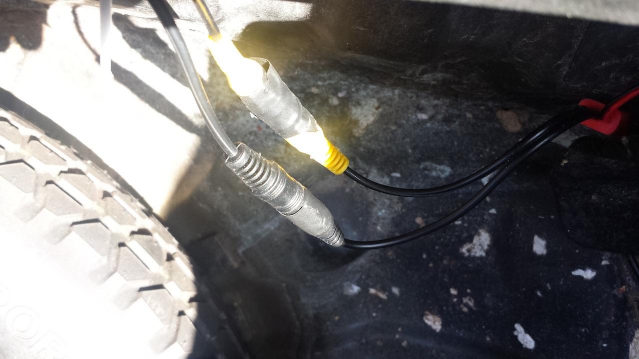

I also have questions on how to install i manage to mount and run the wires inside i taped into the driver side light Orange cable but when i connect to the aux does the red cable have to be connected to a power source? i just get feedback no video when put in reverse.

did you press on the foot brake? i didnt do the bypass yet so the footbreak has to be engadged and on reverse

i tried the brake and nothing..
So here is the current set up,
I have everything connected, came along the driver side and tapped into the orange and black, my guess orange is positive and black is negative. Then i just ran the wire along the side to test it out and nothing still im not sure if that red wire where the aux input has to be connected to something Im bypassing the video by holding down the aux button.
I'm having a little trouble understanding what you've done so far, so i'll just throw these out there....
* i see you're using the orange and black wires, which is correct so if you want to confirm the connection is good just have someone put the car in reverse and step on the brake and use a DVM to measure 12V from the camera plug
* you're using the aux input but the video won't display without the parking brake engaged, so that won't do you any good for a backup camera. we aren't allowed to discuss the "forbidden mod" here either.
So here's the simple test....engage the parking brake, keep your foot on the brake pedal and put the car in reverse and see if the video comes up. If that's the case you've wired everything correctly.
