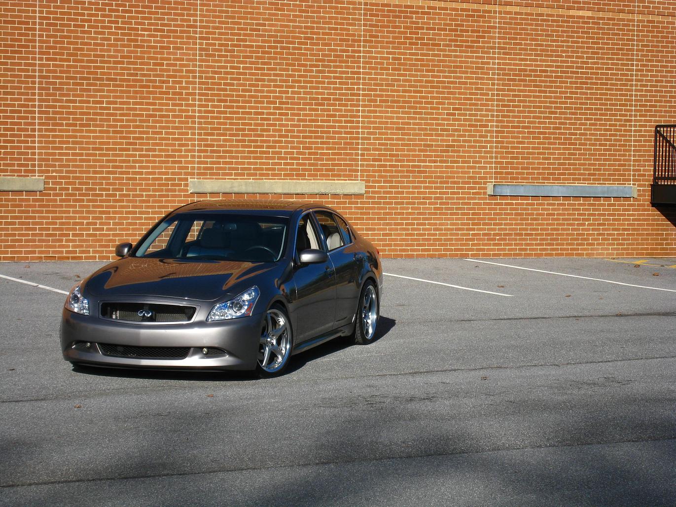

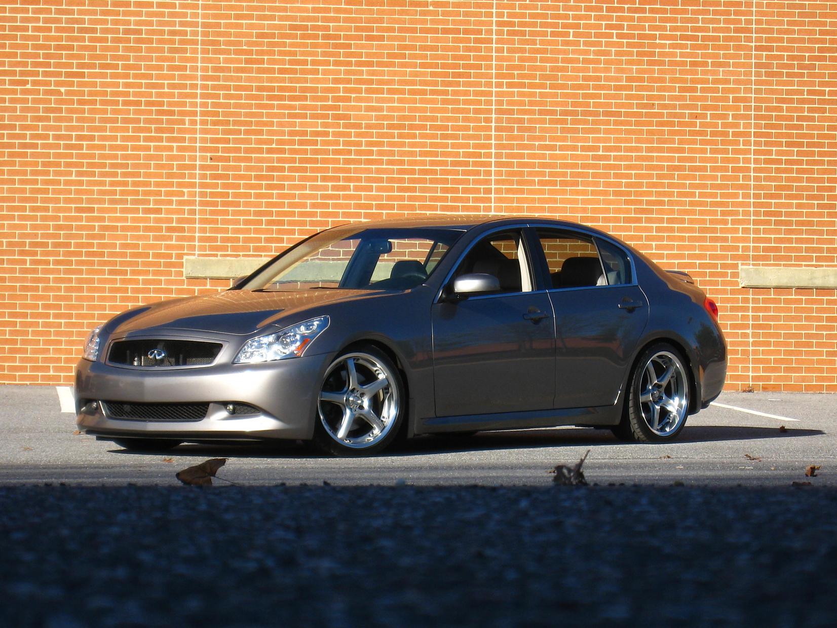

I would do a 15mm spacer up front. I am running a 8.5" +36 and 9.5" +37, and I could use a 10-15mm spacer on my fronts, so you definitely will need to do something if you want them even/flush. I also have Eibach pro-kit springs (rear is about -1.6 degrees camber with a camber kit, and front is about -1.8 with no camber kit).
Pic:
Few more pics here: https://g35driver.com/forums/media-s...g-begin-2.html

[Quick thread jack]
jran76 - How did I miss your pics of the GT-S'... I actually got mine back on 5/29/08 after ordering them 109 days prior. Nice choice!
https://g35driver.com/forums/nationa...ml#post3065004
