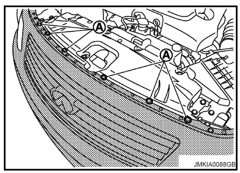

Then there are 6 clips holding the bumper to the radiator cover. remove those with a flat head screwdriver.
Attachment 240395

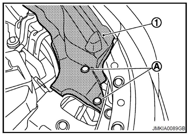

Turn the steering wheel to either side and remove 1 plastic clip on the wheel well lining to access the bolts inside. Once you pull back the lining you will need to use a long extension to remove two 10mm bolts. Do the same for both sides (Marked A)
Attachment 240396

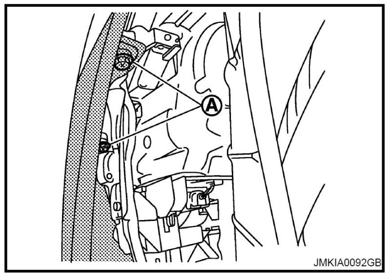

Once that is done, there are 2 more bolts holding the bumper, 1 on each side.
you will need to pull up the rubber seal on the side of the engine bay to access a 10mm bolt as shown below. You will need to use an extension here too. the first pic shows the location of the bolt behind the rubber seal. you don't need to remove the seal, just pull it back until you can stick your wrench in there. Do the same for both sides. (Marked 1)
Attachment 240397
Attachment 240398

How come the FSM for 06 coupe did not mentioned any bolt on the top like you illustrated in your last two diagram? also my engine bay do not have any rubber seal that needs to be lifted in order to access those. Are the G35 different in Kuwait?
Those who have an 06 coupe that have removed the front bumper before, can you confirm? advance thanks.
Those directions are for the sedan, your coupe will be a little different.
