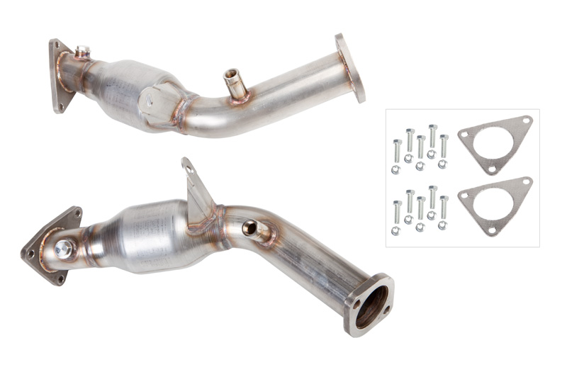

i remember reading when the first high flow cats came out that people had this problem and got rid of them. and it all comes down to the second o2 sensor reading to high/low and messing with the cam timing.
CRAP it is becoming clear for me. I found that my plugs on the camshaft position sensors had bad connections. that caused the car to spit and sputter trying to get the car to run right. in result my catalytic converters were going out from the unburnt fuel hitting the element and exploding. Now that they are defunct it just took it this long to throw the code lol.
i bet your issue is from the installation of the HFC's. the second o2 sensors need to be pulled out of the exhaust stream some.
Old Jan 6, 2010 | 01:34 PM
  #55
ANMVQ's Avatar
Joined: Sep 2008
Posts: 951
Likes: 9
From: Waltham Ma,
So you mean to tell me these are not revised and the bung is not out far enough? How can a get them out more. Does Berk offer something?
