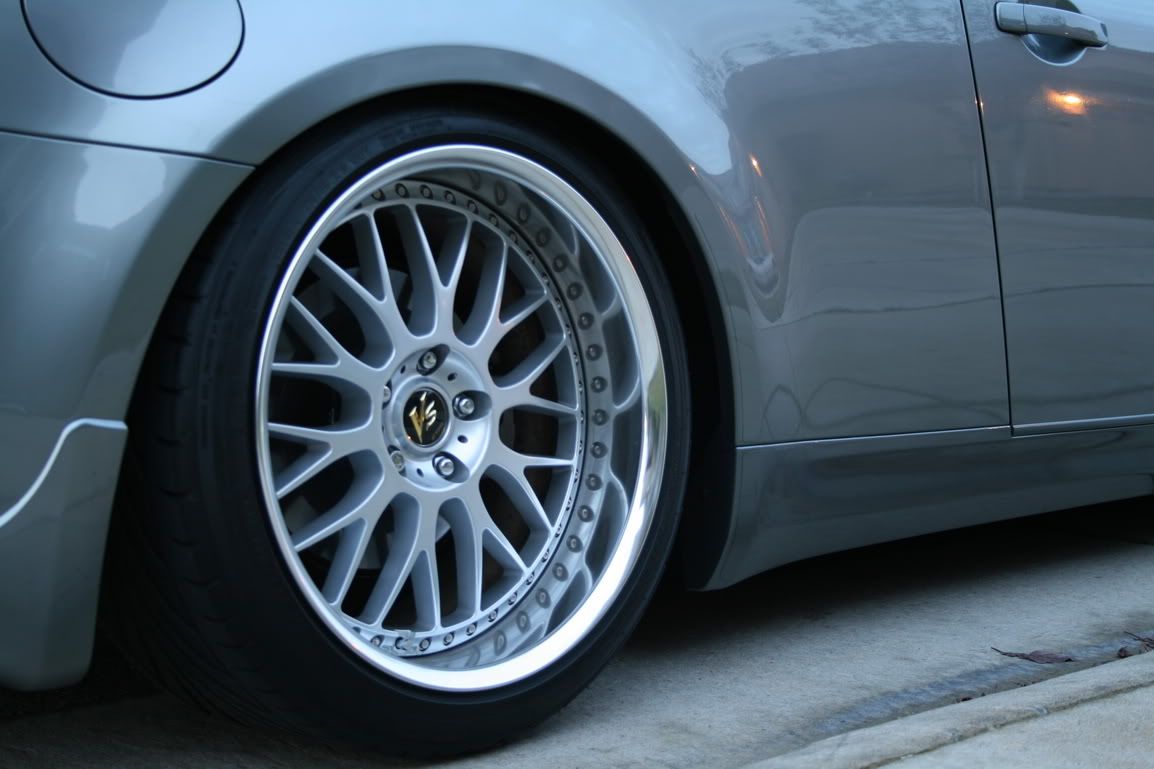

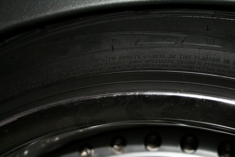

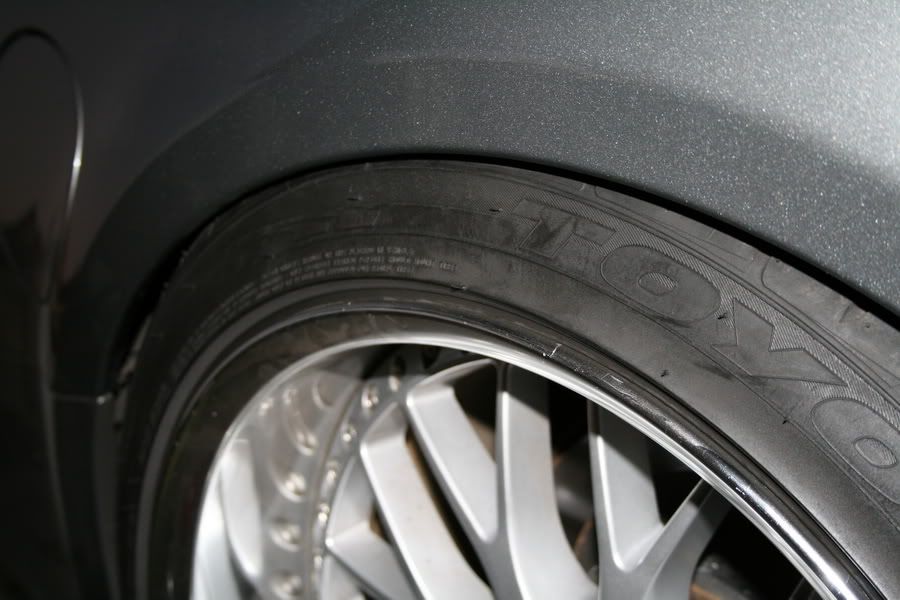

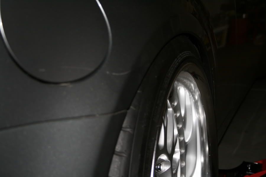

I just got 25mm spacers, and the look is right, but with my current setup, it rubs too much. I think my options are to either run a smaller spacer (not preferred), run more stretched tires, roll the fenders even more than they are currently rolled, raise up the rear a little (not preferred). I already have quite a bit of negative camber from the car being slammed, so I don't think adjusting camber more negatively would be an option.
I am leaning towards rolling the fenders more, but I'm not sure if it would be too much. For those who have experienced this, can you please give me some advice?
Specs: Work VS-XX
19x10.5 +29 Odisk Toyo T1R 275/35/19, 25mm spacer
on Tein Flex coilovers, spring mount mod, 1 spring perch removed, lowest setting
Thanks
Without spacers:

so you would now be a +4, I would suggest. Rolling your fenders paper thin, and going to a more stretched tire 265/30 19 maybe.
Old Jan 17, 2009 | 09:30 PM
Cost a G's Avatar
Posts: 972
From: Long Beach, CA
Get smaller tires. I would go with 255/35 19

Try rolling more if possible. Mine are rolled almost flat.
And up your dampener setting. Tein Flex are adjustable dampers right? (sry I'm a Cusco guy so don't know)
Or as mentioned, less aggressive spacers.
275's already stretched enough imo with using 19x10.5's.
