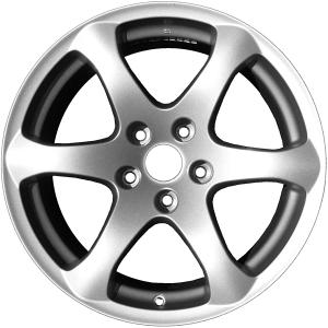

Can't seem to find a straight answer....
Do OEM 17" 6 spoke Infiniti rims fit a 2006 6MT Coupe with 19" rays???
Old Dec 12, 2012 | 11:18 PM
  #4719
4DGS's Avatar
iTrader: (69)
Posts: 14,524
Likes: 981
From: Ontario, Canada
Yes, as long as the car isn't equipped with any kind of big brake set up.
Old Dec 12, 2012 | 11:27 PM
  #4720
krazzyborri's Avatar
Joined: Nov 2011
Posts: 55
sweet thanks!!
