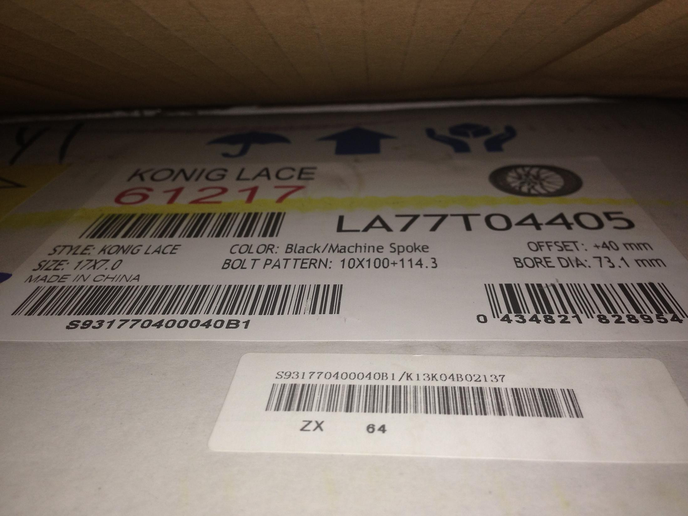

Okay, so i was checking out the boxes that the rims came in & saw this.. i posted a picture of it under here. Does this mean this is the correct size then? I think they entered the information wrong on the website because it also came with the universal version of the rims.Originally Posted by Bousou_G
Yeah dude return them, the bolt pattern you bought is smaller.
Quote:
If it had those numbers than I'd say they are universal meaning that it fits 100-114.3. But you might want to double check that....... one tip is do your research, don't impulse buy.Originally Posted by erickLA
