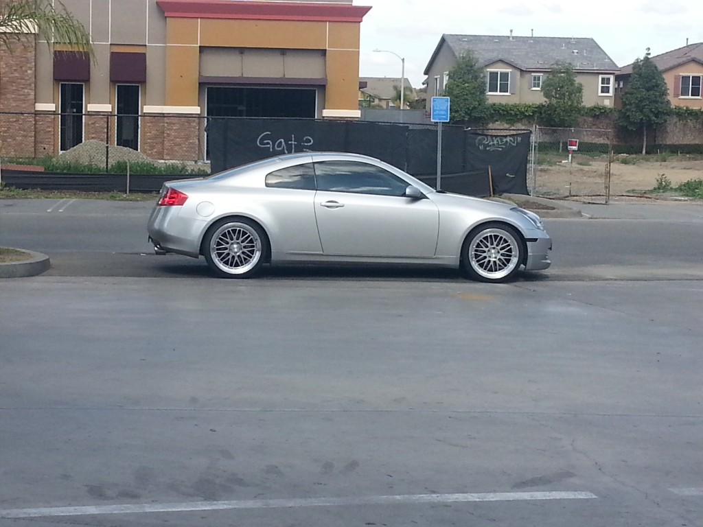

New wheels & tires
What y'all think? Lower it?
